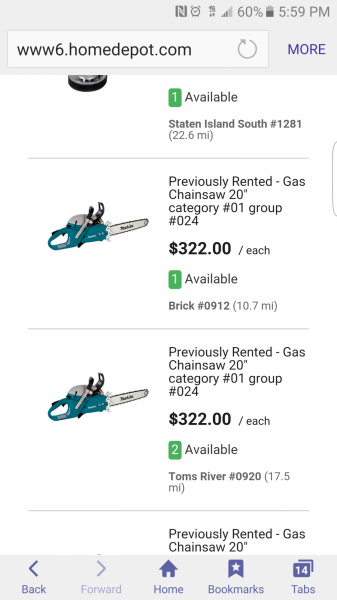

    Here ya go. These are only about 20 minutes from me. That's the 6421.
    Horkn, CoreyB and My IS heats my home like this.

    From all the talk. I would go 6400 or the 6421 for the extra power. I personally would snap up one of those rentals for that money, seeing the quality of saw that some guys are getting from HD rental units. Use the extra money for the big bar and chain.
