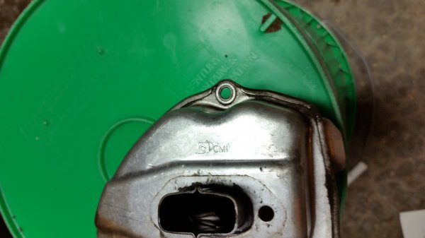

    The only tough part I've found with most stainless steel mufflers is getting the crimp lifted at first because it isn't as soft as regular steel.
    The 6421 is nice because if you start at the top hole you can work a small flat blade screwdriver under there pretty easy. I also found that if you heat small sections at a time and work the crimp open it worked better than heating larger sections and working the crimp open. Maybe a half inch at a time. Pretty easy it just takes a little time and patience. 20160803_212053.jpg

    Forgot to mention that once I got the crimp worked open I switched to needlenose pliers. Also you shouldn't have to go all the way around before you can work the two halves apart.
