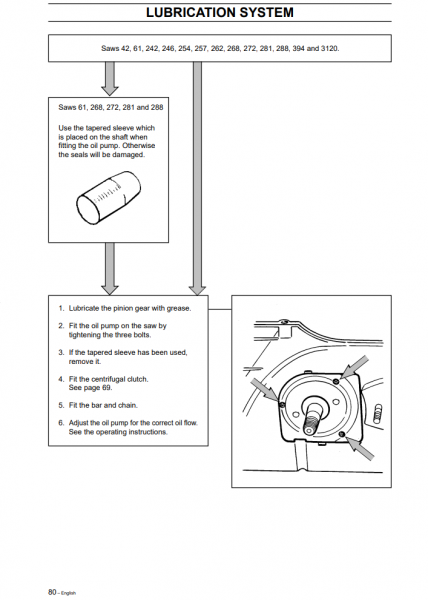

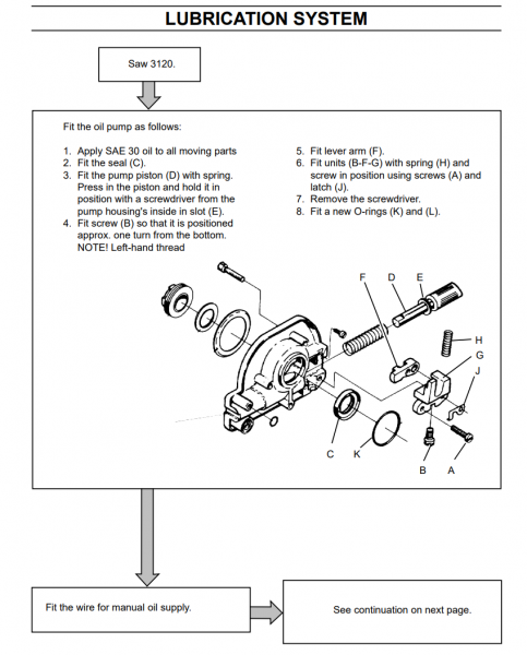

    I downloaded the Operator's manual (seems like it covers ALL Husky saws) and for the 3120 there is a special section for oil pump assembly and it does not mention anything about sealing the outer edge of the oil pump. The few videos I've found on YT also don't show that step either. That's weird.
    That said I think I'll just use some extra exterior silicone sealant that I have. Looked up the IPL and that foam piece is there to filter the opening for the oil flow adjustment screw. Not sure why there was plastic there though.

    I didn’t see anything in the service manual. But out of a dozen new ones that I’ve had here, the oil pump is siloconed to the case
