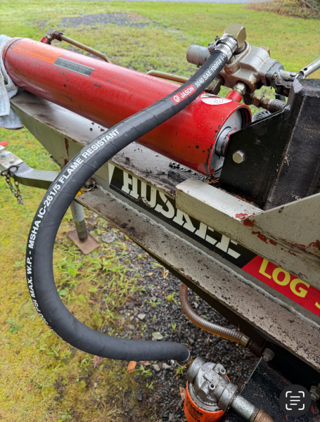

    Finally got around to replacing the return hose. Old one popped off one too many times. PaulB’s didn’t have the t-bolt style clamps small enough for this size so I just doubled up for now.

    How much do they charge to personalize them like that? :D

    Ha! I thought it was pretty neat when I saw that. Had to make it visible. $8.99/ft for 3/4”, posting for future reference.

    I know it's only a return line. Those hose clamps dont really do much on a wire braided hose. If anyone else needs return hydro line, fuel oil hose (any that is oil resistant and will take a little temperature) works great and will not have the wire in it. Being a return there is no need for the wire at low pressure and the wire means that you can't really clamp it down anyways...why pressure lines are always crimped or use screw on fittings. There is such a thing as low pressure hydraulic hose, but we didn't carry it because the fuel oil hose covers what it does anyways.
    I have spent a little time behind the counter at a hose shop. I sortof remember some stuff.
    My feed line to pump from tank is leaking. Trying to get my stuff together to convert to ATF and will address at that time. Thinking that I will magically find the ATF for $30/bucket has held me back a bit probably from getting it done. :rofl: :lol:
