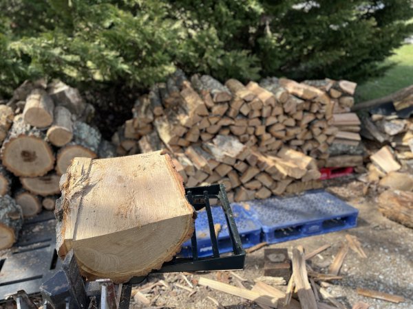

    Done deal. Ran the cylinder back and forth many times, split an ugly crotch that stopped it too. :eek: Then topped off the hydro tank. I think I pretty much used about 8 gallons in this thing. My 2nd bucket is darn near empty.
    I got about 7.5 sec out and 6.25 return. I'll have to find the post where I timed before the change. Seems a bit quicker and it's definitely quieter!

  3. brenndatomu
    25,091
    162,981
    Stopped it, as in stalled the engine, or popped the relief valve open?
    In the video, is the engine WFO? If so, doesn't sound like 3600RPM to me...and since these are PD pumps, RPM is speed 1:1
  4. The Wood Wolverine
    18,829
    121,162
    No, I've never stalled the engine. Ram slowed to an eventual stop, it was a gnarly oak crotch, but revs just dipped a bit.
    Yep, engine is wfo. I do have a Fast-Tack for saws, next time I have the splitter out I'll check rpm. And I'll eventually add that pressure gauge you shared.
  5. brenndatomu
    25,091
    162,981
    Correcting my missed typo...RPM = flow, 1:1

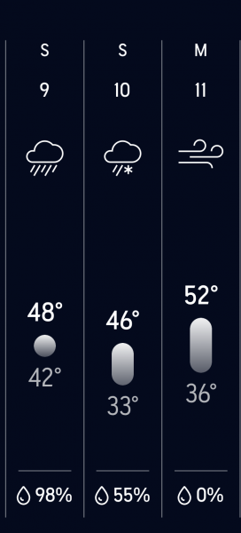

  10. The Wood Wolverine
    18,829
    121,162
    I was hoping to give it he11 this weekend but nooo..

  12. Locust Post
    8,950
    52,502
    same here, just got my big saw back together and would like to sink it in some big wood.....rain, rain go away

  16. The Wood Wolverine
    18,829
    121,162
    Yes! The old pump was becoming a bit whiny. Lol. Return stroke is a good bit faster. Still haven’t found my post with old times. When the ram extends to the point of wedge “bottoming” out, motor doesn’t really change load. Before it would cough heavily. I always told dad to try and prevent that but his hand/eye coordination wasn’t quick. Now it’s bypassing instantly. :thumbs::thumbs: And when hitting hard stuff, the change to slow speed is seamless. So all in all, two thumbs up. Just hope it lasts as long as my old one.
    And the tank is sitting at an angle so the overflow is probably from that.
