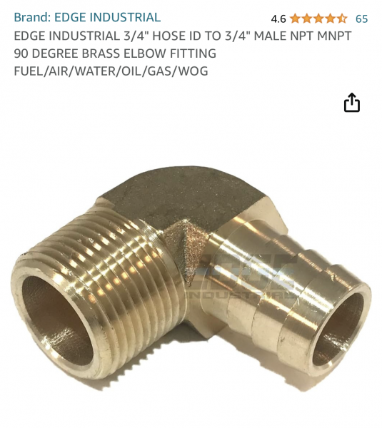

    The feed port is very bottom dead center and the return is off to the side. No easy way to modify that. Here's an internet pic to show as I'm at work.

    Best you can do without draining and adding another port.
    Not an easy thing to do and then you have the risk of debris from cutting and welding in the system. That's not a good thing.

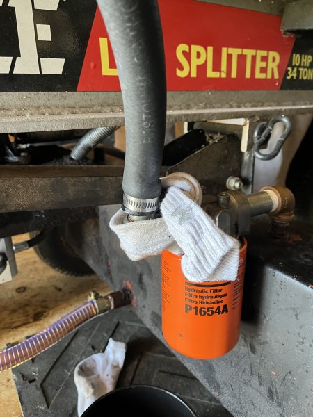

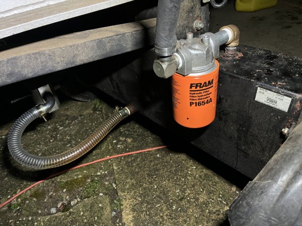

    Got a bit done today.
    Filter relocated, feed hose hooked up, tank partially filled and oil changed. That old return hose was a sunuvabitch. Hoping to get it further after I get it warm.

    Looks good! Looking forward to it running.
  15. brenndatomu
    25,091
    162,981
    Looks to me like its ready for liftoff...:binoculars:
