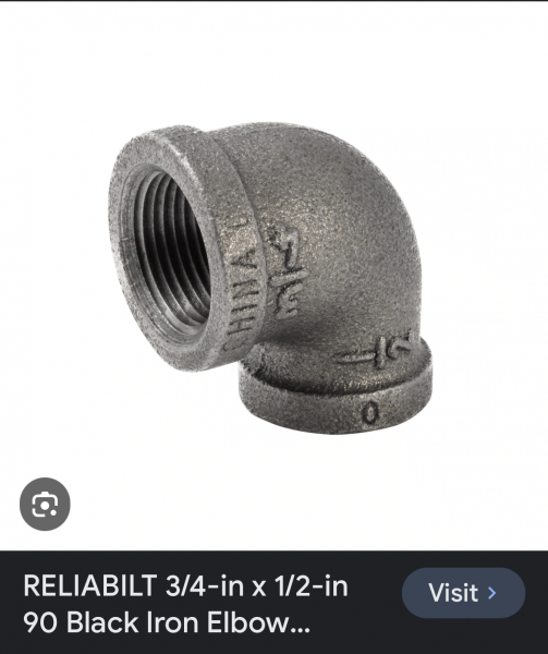

    So.. just elbow and mount the housing there;
    Seems the best option IMO. Only alternative would be to drill a hole and weld like this (thumbs down smiley here).
    Wwyd?
  5. brenndatomu
    25,100
    163,076
    The elbow looks like a good solution...and neck down to 1/2" after the elbow...you can do it however you want, but I'd use a 1/2"-3/4" bell reducer, instead of a 1/2"-3/4" bushing...

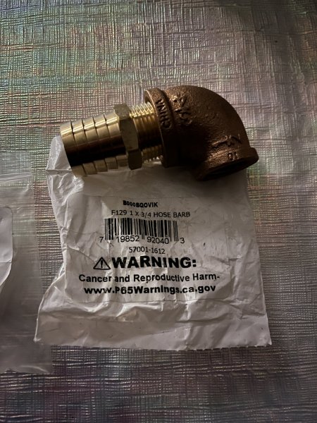

    I actually ran to TSC tonight and bought a reducer, an elbow and a piece of straight. Ended up getting the wrong size. :picard: They didn’t have the barbed hose adapter. One size off so might be waiting on that :ups:, unless I can find one tomorrow. Should be able to find an elbow that will adapt them…
    I have no knowledge of hydraulics so I’ll take you guys advice! And then thank you for helping me. :handshake:

    Is that a 1" x 1" barbed fitting?
    T.Jeff Veal likes this.
  19. The Wood Wolverine
    18,839
    121,252
    It’s not supposed to be.
  20. The Wood Wolverine
    18,839
    121,252
    Made me go out and test fit. The package numbers are misleading.
