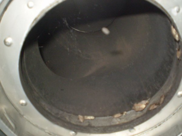

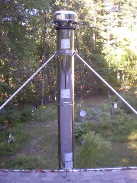

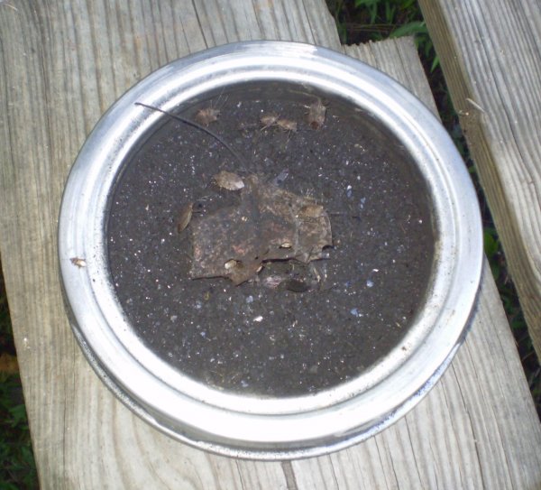

    Ok, glad you ask. Yes, I inspected the chimney. I was able to shine a light up to the top of the chimney. What I saw was dull soot; it did not look shinny.
    Photos:
    This was the bottom cap for the tee; dry soot particles, a leaf and stink bugs, they get in everywhere. I am wondering if they have gotten into the stove as well.
    It basically lo0ked like this to the top of the chimney. More stink bugs. Clearest I could get with the camera; it only has auto focus.
    Now about adding the section to the chimney
    That is a three foot, two foot and one foot sections plus the cap. I have a three foot section I want to add. It scares me to be standing on the edge of the roof. I don't have any safety harness here or even just rope. I guess I could leave the two foot section on and try taking the one foot and cap off, adding them to the three foot section then try to hoist them above my head into place. I am also thinking about putting in a Craig's List advert and just see if I can hire someone to do it for me.

    Your chimney looks really good and clean Kimberly. Why do you want to add length to the chimney? If it's currently above the roof ridge it should be fine, especially being right at the edge like it is.
  13. yooperdave
    35,881
    225,758
    It should be two feet higher than anything within ten feet of it.
    K wants to add another section to it just to increase the draft. (once its up to temp)

    The height requirement as listed in the stove manual; Madison from England Stove Works, is not met. So that is why I was going to add a section. The chimney is a bit short according to the manual. Plus, there are two 90s, one in the flue and then the tee in the chimney. From what I understand, that effectively shortens my chimney even more.

    Just remember, the stove can work just fine with a shorter than recommended height. Remember the "two feet higher than anything closer than ten feet" rule though.
