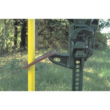

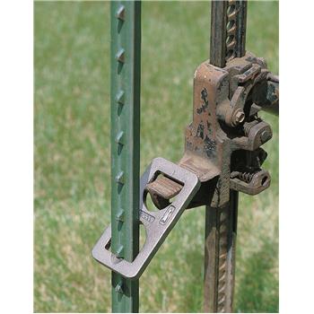

    I've wrapped a chain around post/rebar then placed a pair of vise grips above the chain to keep it from slipping while nacking up with handy man jack (what then Hi-lifts are called around here). Might be less to carry than the pipe wrench.

    If there one thing I have plenty of, it's bottle and can openers. And no shortage of beer/alcohol. :cheers: :dex:
