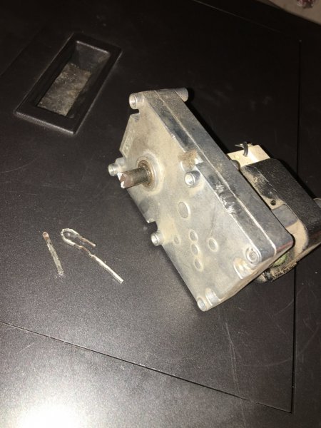

    The HR West Point & Saranac stoves are no longer made but with good new parts can still keep on burning!

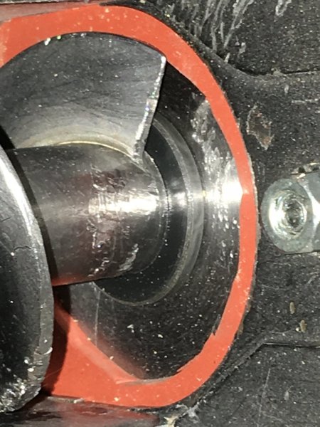

    I just came across a Saranac 50k BTU stove with a banged up auger bushing with the auger attached with one of those cotter pins you push in and bend the prongs back! It was working but turning very ruff.
    So after struggling to get it out the auger motor shaft broke! LOL

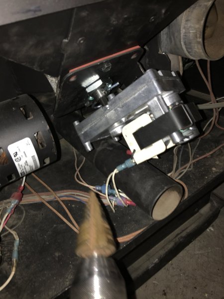

    So, using a titanium step drill bit from Harbor Freight, I stepped out the hole for the larger Nylatron and the auger turns like butter!
    The bushing was less than $20 bucks!
    Pic 1 - old auger motor with broken shaft and ripped cotter pin.

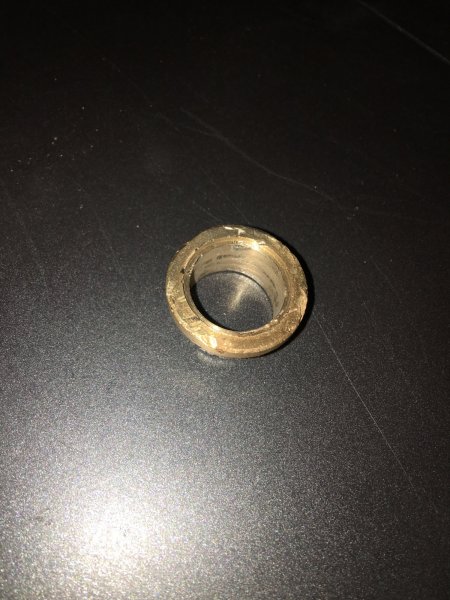

    Pin 2-3 old bronze auger bushing

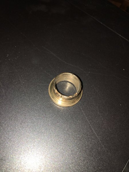

    Pic 5 - new auger motor, hitch pin and Nylatron bearing
