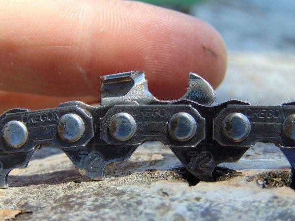

    It helps when following up with a double bevel too. Here a pic of a chain someone else did for me:
    That tall side plate profile helps keep the gullets cleaned out.

    A file does the same thing. The side plate is only going to sever what your rakers are set at.[​IMG]
