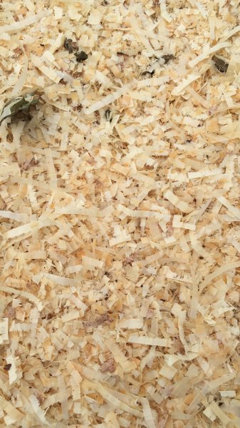

    Long crosscut noodle chips are from higher rakers...the tooth doesn't have to rock as much and slices through the wood, rather than rock and take a chip out. I'd say it's smoother like that, but maybe a hair faster with lower rakers

    I'm thinking more along the lines of chip flow.

    I was thinking that long chip was from when Mike Lee was in PA and they had the mini gtg a couple years ago. Either way, I'd think a sharp chain would pull a long chip like that too

    Those first pics were when MrLee gave me some lessons. The poplar strings were Dall chains. Typically I keep em at 25 with a progressive guide. “Fast” chain gets filed to suit the saw revs I want.

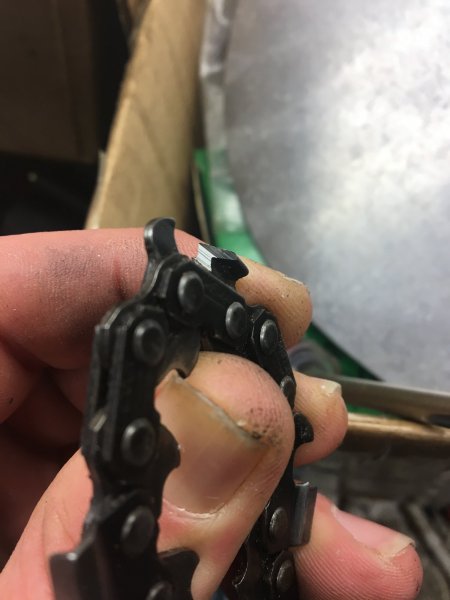

  17. The Wood Wolverine
    19,001
    122,753
    That chain wouldn't load up the saw as sent, so after I lowered them it was game on.
    Tom, as Mark pointed out, the wood I was cutting had a decent amount of moisture in it, so I'm sure that attributes to the long chip. Dry wood isn't going to stay together like that.

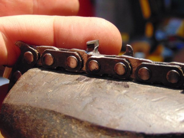

    Here's a pic of a race chain I studied. You'd have to ask the experts questions in that regard. I'm a firewood hack learning this stuff too. Second pic is my hand filed.
  18. dall
    dall
    Sep 6, 2017
    5,436
    12,070
    West Virginia

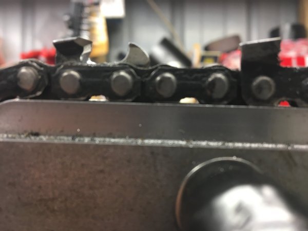

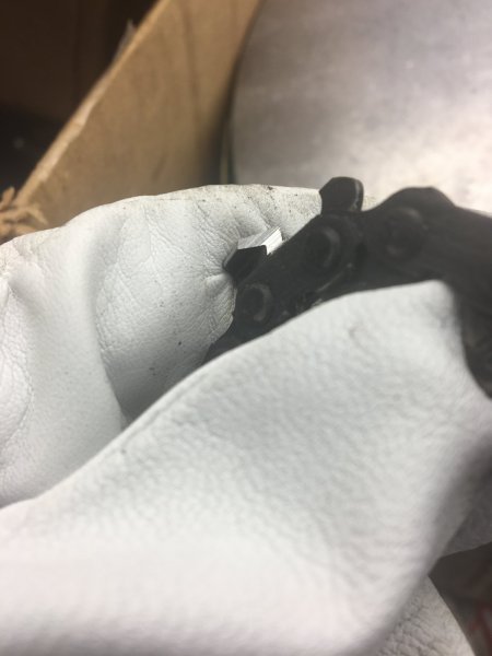

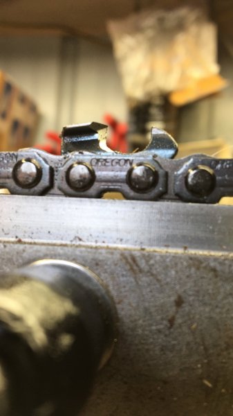

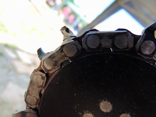

    IMG_3675.JPG IMG_4014.JPG IMG_4124.JPG IMG_4546.JPG IMG_4787.JPG IMG_5113.JPG IMG_5115.JPG
    First picture is the ny grind 25/15
    Second picture is the pine at spring gtg 25/15 grind and rakers at 35
    Third picture is the 20/15 jason posted chips of
    Forth and fifth picture is the 15/20 grind what I have been using until new grinder
    Last 2 pictures is new grinds the ones tom has wheel set the same just guide wheel and arm moved slightly
  19. The Wood Wolverine
    19,001
    122,753
    This one is nice.
    I like the tall sideplate grind.

    That's what I had at the fall pa gtg
