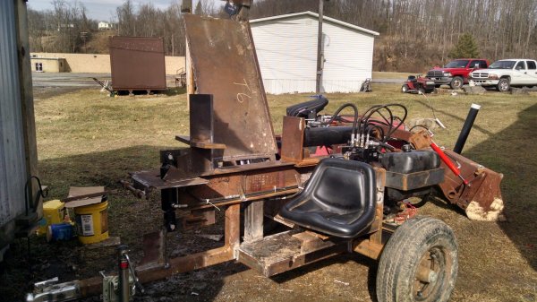

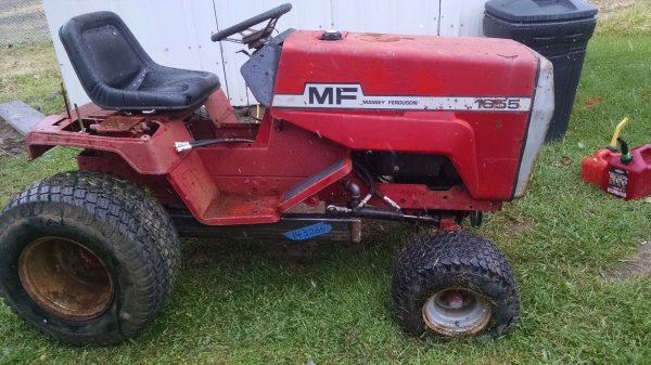

    My splitter and my little tractor second picture was how I got it and I added a subframe for the loader and the power steering
    Power steering is ran off the hydrostatic transmission and the loader runs off a electric clutch to pro

    Nice splitter Dallas, even has a seat fer slackin' if ya want to! That looks like a tough little MF'er ya got there too.

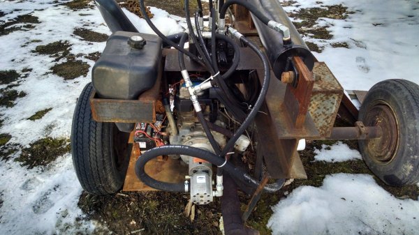

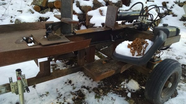

    lol i built the splitter for my buddy who has a bad leg to run but he never has it has a 12.5 kohler engine 16gpm pump 5 inch cylinder for splitter 3 inch cylinder to raise and lower the 4 way wedge and a 2 inch cylinder for the log lift
    the little massey has a 18 hp kohler magnum engine 5gpm pump for loader cub cadet power steering parts from a 1864 because the massey was manual steering factory the loader came from a john deere 2320 that caught fire but structurely sound so i replaced all cylinders 2.5 inch on lift arms and bucket curl instead of the original 2 inch cylinders i have 850 pounds counterweight on the back as well
