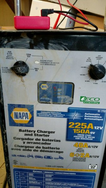

    Ok. So you have it wired in series. 24 volt system. To use a 12 volt charger, you'd need to hook the leads to + and - on only 1 battery at a time
    Make sure what you're hooking it up to is a 24v system

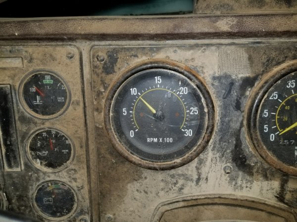

    My beast is alive.

    Is this the problem ? Or are we just hooking the leads on wrong?
    Stump Shot and huskihl like this.

    M35

    You need to separate them and charge 1 at a time or 2 12v chargers or 1 24v charger.

    ITS ALIVE and running muahahaha. Thanks to all of you "hows you" guys!!
    (his truck on one batt and the charger on the the other batt)
