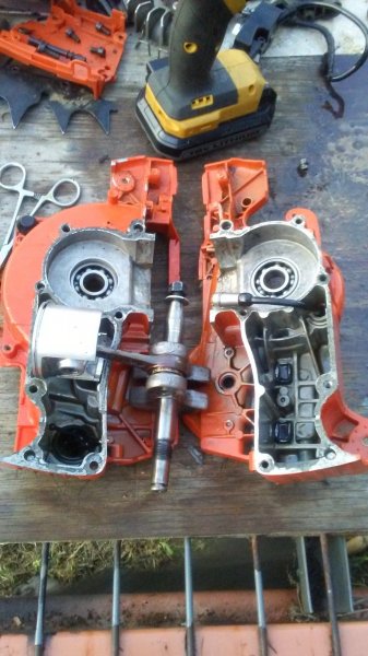

    I thought my case gasket was bad but the case bolts had loosened on my 268/372 saw pulling bar oil in when on it's side quite impressive smoke lol.
    I'm going ahead and tearing it down for new gasket and seals.
    Bearings feel like new.

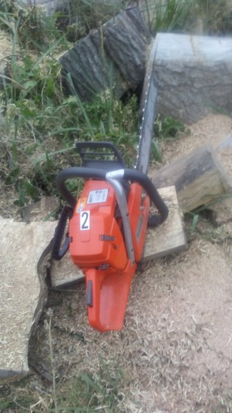

    Number 2 big bore is tuned and in the jeep for a few day's.

    Still haven't come across any old pioneers im sure there is some here.
    Finished tearing the 268/372 down
    Would've been about 10 minutes but these have that external tank vent that stick's on the case.
    Took about 20 lol
    Bearings feel new so just seals and a case gasket and it's back in business.
