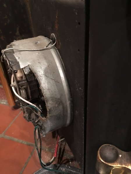

    As far as running without fans, my Napoleon 1401 doesn't throw a ton of heat without them. When the stock ones went out I replaced them with some 4" duct fans from lowes. Trimmed the duct to fit in the stock opening and have been working great. Cheaper and much quieter than the stock ones. Put them on a variable speed switch too where originally it was either on or off.

    My 1401 does pretty well without the blowers on. It's in a decent sized masonry hearth opening and radiates well. Not like a stand alone would, but it still has enough exposed surface area to heat the room without having to be over-fired to do it. Any chance you may have some pics of your blower conversion? I can tell the bearings in mine have had better days and I really don't want to rebuild these or replace them with the same ones if I can find something a bit less noisy and more efficient.

    I can take a couple pictures tonight when I get home if I get time. I used some suncourt inductor fans, think they were like 25 bucks apiece. Gotta get in there to vacuum, have been neglecting that for a while so I'll take some pics.

    They are a huge PITA. I found it easiest to just leave it screwed together and take the sorround off and take the covers off that way.
    PogoInTheWoods, I totally forgot about the pictures, sorry. Like I said, 4" inline duct fan trimmed up a bit to fit in there and secured with some wire to some screws. Pretty crude but works well and very surprising how much quieter they are over the stock ones. I was worried about the plastic fan blades at first but been fine for 3 seasons, must not get too hot in there. Don't mind the dust bunnies, gotta do my final season cleaning soon.

    That is some superb redneckery, my man! I'll definitely keep those fans in mind when it's time to swap mine out. Thanks for the pics.
