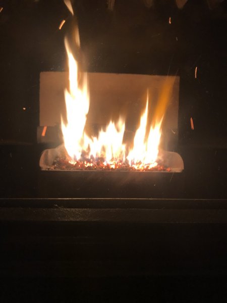

    I put it in the way the stock one was set up. I just cleaned the stove, cleaned the holes and that’s my flame. Something is up

    I had to manually light it again and it’s almost like the hot pellets aren’t lighting at the bottom and are getting up near the edge and then burning. I noticed the center doesn’t burn so well

    IDK about the center not burning as well. Ive seen my P68 do that recently and look like your flame especially whith a low/medium size flame. When running full bore its fine. I havnt thought twice about that.
    Now the bulge under the burn pot. That doesnt sound right.
