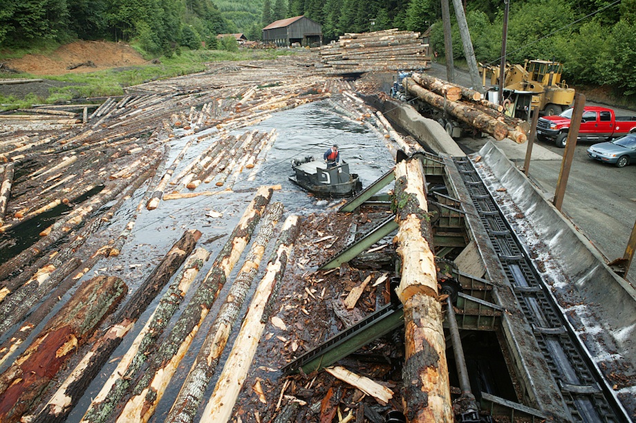

    This is the Hull-Oakes log pond near me. We still have a few log ponds around.
    Since you're in Louisiana, perhaps you have access to a pond that's been overlooked?
    I like everyone else's responses too.
    Other mills deck logs with sprinkler systems on top, this is partly due to fire but
    mostly due to keeping the logs from checking.
    All our west coast mills use a de-barker as well.
