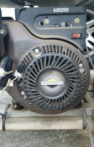

    This is my engine off my generator. Its a 10HP briggs. About 15 years old. If you need the model number i can post that.
    But my rope is worn and i shortened it before it broke. But i was going to put a new rope on it so it doent bust as i try to start it in a power outage. How do i take it off? Looks like its rivited? Do i have to drill those out to get it off?

    I did mine like this guy.
    It's a really bad video but the info is good. Worked on my splitter.
    I didn't cut the metal like he did. Just bent it enough to get the knot through then straightened it back out.

    With the rivots you need to remove the 5 screws that hold the whole motor cover on

    Yeah do like TurboDiesel said and remove the cover/ blower housing. No need to drill the rivets.

    So can I not do like the video and cit part of the recoil cover off and feed it through? I haven even went out to look since it got dark.

    I usually drilled and re-riveted these when I ran into them, but the method in the video looks promising.

    That video worked like a charm. My rope was a tad thicker, even though I think it was the same size he said, it's what I had and I was going to use it anyway. I keep 3 sizes on hand. 3mm, 3.5mm, and 4.5mm. I just had to work it though the recoil and the handle a little. Did it in like 10 mins. Wy better than pulling all that mess off.
    IT worked for me!! Did just like the video! THANKS TurboDiesel !:dex::dancer::rootintootin::banana:
