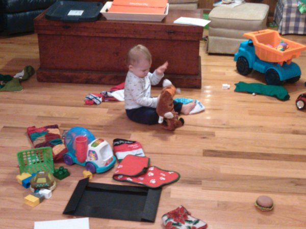

    Unless your going real cheap you can have real wood for the same cost or cheaper than many laminets. Course the fake stuff holds up to claws better.
    I put 3/4" thick 3.5" wide red oak in my front room. I think with wood, materials including tar paper nails and paper and 7 coats of varthane I am into it about $4/sqft.
    Ignore the Christmas mess!!!:) IMG_20141223_182350_892.jpg
    eatonpcat, milleo and wildwest like this.

    I have alot more to say, but foremost, your son is ADORABLE!
