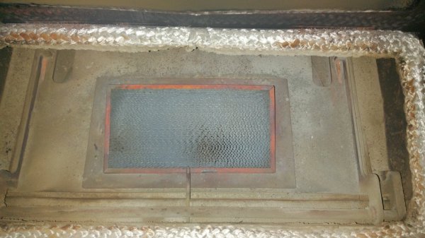

    This is a pic of how my catalyst probe is positioned. In a black box when I load it I see temps of 1500° with stove top at 600° or less. I have seen and recorded cat temps over 1600° a few times. Not on purpose and my draft was set low woth those temps, and no sign of cat damage at all. I usually have my draft one or two notches under the first big one. 2-3 yr dry ash and maple is all I use. 20170326_192659.jpg

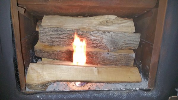

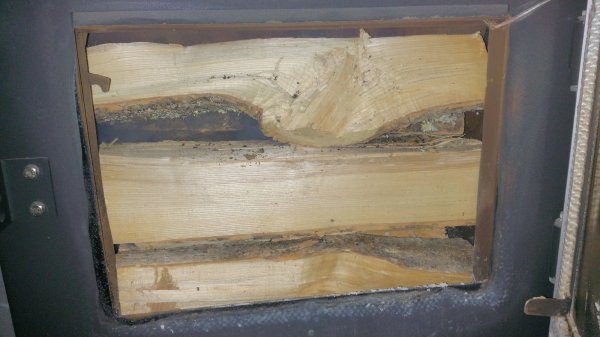

    381
    This is how I load my stove. Fill halfway to the frt and all the way to the secondary plate, light 1/4 piece of a super cedar and fill the remaining space. 20161204_203318.jpg 20161204_203458.jpg
