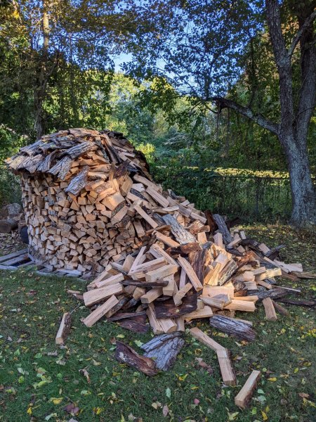

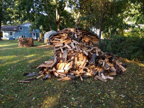

    I assumed I'd be posting this thread at some point, as it was just a matter of time. I noticed the back side of the mighty holz hausen was looking a little "off" a few weeks ago. The interior wood was starting to settle and was causing the walls to bulge a bit. "She's gonna fall," I told a friend while we were playing a round of bocce.
    And today was the day! I was mowing the lawn when I noticed it and I just had to laugh. I can't even be the least bit disappointed, because I learned a lot from my first 'hausen. I'm definitely going to restack it, and now I know how vitally important the horizontal rings are. (see the small 'hausen in the back of the pic)
    So now I get to build an even better, more secure 'hausen and I'm really looking forward to it. Maybe I'll put a window in it? A design of some sort with a darker species of wood? Who knows. It's definitely going to be another work of art.

    Ok, any tips we should all know as to why it happened?

    I was guessing gravity... sorry :handshake:
    That and drying made a side settle

    Not enough angle in the outside ring of splits. The outer ring has to be stacked so that it has a pretty distinct pitch down toward the inside, if not, the splits inside slowly drive the outside walls outward until there is a 'blowout'. The key is to put the occasional split sideways all the way to the outer edge of the hausen to maintain that pitch all the way up. That is why there are usually splits visible that ring the outside of a hausen, they are there to maintain that angle.
    My wife builds a nice holz hauzen but allows the outer ring to become flat or sometimes even pitched toward the outside. They always blow out. But she does not mind stacking them again so..... the wood gets a lot of miles on it before it gets to the stove.
