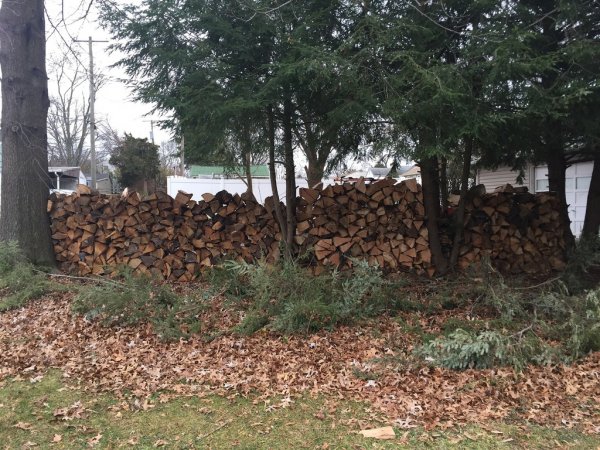

    Lots of good advice already provided but I will chime in and advise do not stack your wood in the locations you have chosen.
    Under trees conifers that you may think shed water will drop plenty of needles that absorb water and keep your seasoning wood damp, promoting rot and bug infestation.
    You're top 2-3 courses could turn into punky-rot and lower levels will grow mushrooms

    Get a moisture meter

    Another vote here for the moisture meter. If you don't have dry wood this year, I'd use the gas and take it as a learning experience. It looks like you live where neighbors are relatively close. Smoking them out with wet wood does them wrong and makes wood burning look bad. Waiting until you have dry wood is courteous and reflects well on all of us.

    A moisture meter is the only way to know where the wood you have is at. Poplar, if split and stacked will be easily ready in a year. It seems to season properly in 9 months. Oak, yeah, 3 years is a good start, but 4 years seasoning and you'll know it's good.
    Dead standing trees, elm, cherry, and ash would be 3 species to target. Dead standing elm, when the bark has fallen off is usually good to go providing it hasn't rained out snowed a lot recently.
    You'll find the mm will tell you what's good or not now, or for later. Dead standing trees. From a good 6-8 feet from the ground will typically be good. Tree trunks that are still attached to the ground will carry more moisture as the wood does act like a wick to a certain extent, although the living trees actively suck water up the tree through turgor pressure.
    A couple of weeks ago, I cut up and split a downed dead American elm top that ended up being 2/3 of a cord of dry ready to burn wood. I've been burning it since that day, Moisture content was no more than 19%, but much of it was 15%.

    glorth2 you have been given some good advice by others and I can't offer a lot more but will try.
    First off basod really hit the nail on the head with your wood pile. I was surprised others had not picked up on this factor sooner. If you look at the picture, the first thing that struck me was the fact you are stacking against trees which can be bad as it will damage the trees. Wind moves the trees and the wood rubbing can cause the damage. Then consider that the wood is stacked under all those branches. Trees are close together and it appears also close to buildings. End result is a definite lack of air flow. Sunshine usually is not real important (air flow is most important) but in your case some sunshine will help. In addition, if you have sunshine on the wood stack that also means the wood is stacked more in the open air which is what you need.
    Another thing that could help you for this winter is to go through that entire wood pile and split those splits again. Make them smaller and they will dry faster. Again, the air will get to those fresh splits to get rid of some moisture quicker.
    One more thing is to do some reading: Primer on Woodburning by Backwoods Savage
    Are you screwed for this year? Not necessarily so. Sometimes we just have to burn what we have on hand. You can aid the burn though by splitting the wood smaller, getting some perhaps in the garage and out of the weather. Getting some of the compressed sawdust to add to the stove which will help the higher moisture wood get rid of its moisture quicker and also give you heat. Pick up some old pallets and add some of that wood to each wood load because usually those pallets have some very dry wood which will aid the fire a lot.
    By all means, I would not wait until next spring or summer to clean the chimney! Of course, if you can check it from time to time this will help but not all allow good checking so a cleaning might be best. I not so fondly recall one winter when we cleaned our chimney 6 times! We made do that winter and no, we did not freeze but we tended the fire a lot!
