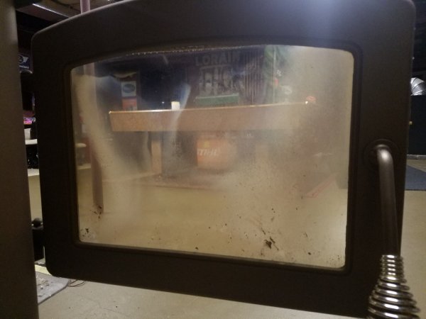

    I have cleaned mine twice. Once was at the beginning of the season and the other time was around the beginning of January.
    Dry Wood and burning hot keeps it nice and clean.
    No fire here tonight as the kids are at my parents. So me and the wife went out to eat and are being lazy on the couch.
    It is a little white/tan from the ash. But you can really see the airwash path from the top to the bottom.

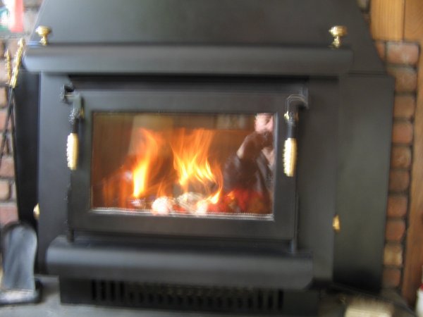

    That's how mine stays so I don't mess with it. As long as I can see the fire. Chief

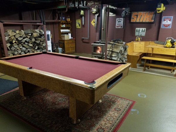

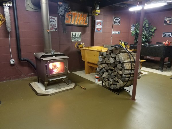

    DexterDay, beautiful hearth and stove. Chief. Wish I was there warming my back

    Thanks bud! It's just my basement. Many don't go down there. But we like it! :)
