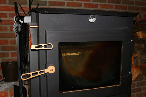

    Yes, but only on the really low burns. Usually burns pretty clean if there is some secondaries going. But the no flame and dark firebox leaves my door coated black though it seems to burn clean after the cat (no smoke). I've run plenty of Ecobricks through the stove, and my ash I'm burning was stacked in '13 and under covered porch since fall.
    Hard to read but thats 1200F on the cat probe, 500F on the stovetop.
    Self cleans just fine the next burn.

    Thanks for the picture and details.
    My theory is the BK and IS can burn at lower settings than the Fireview and that the black on the glass happens even with very low moisture fuel. While I will not use CWF, I will attempt a burn in the future of my Fireview at a close to zero air setting to see if I get any build-up.
