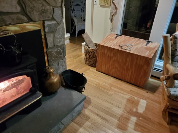

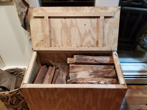

    20211201_062218.jpg 20211201_062218.jpg 20211201_062227.jpg 20211203_202703.jpg 20211203_202703.jpg A couple days worth in the box and a couple weeks worth right out side the back door.

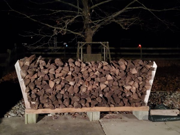

    We keep around a cord in the garage and pull from that. No more than a stove load full in the house. Bugs have never been an issue yet. Our wood is a minimum of 3 years old so pretty dry. I feel that helps with the bugs.
