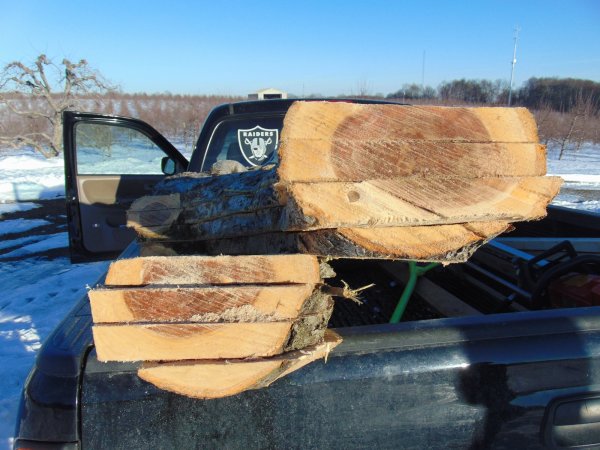

  4. The Wood Wolverine
    18,926
    122,056
    Alaskan MK-III Mill 48" Chainsaw Mill | Granberg International
    The buyer of my slabs is supposed to contact me this weekend. I cut 2 more trees worth last weekend because the others were buried in snow and I didn't want to dig them out. Since this guy is close to my friend, who's family owns the orchards, I'm going to ask $100. Everyone else from here forward will be per slab and not as cheap.

  6. The Wood Wolverine
    18,926
    122,056
    $100 for 4, or 1 tree worth.
