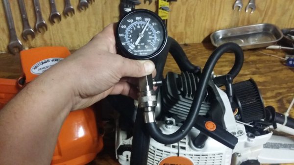

    This is my little 261.. It's about 190 psi :dex:
    Never tested my 460...

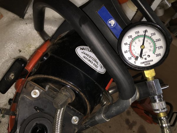

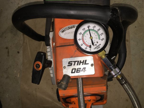

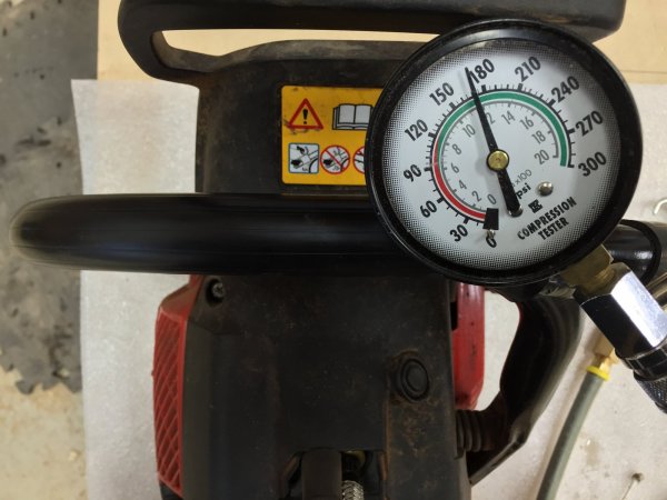

    Just tested today... both around 180 psi. I thought they would have more. Like I said before, the 288xp I got from Neal Murphy has 183 on the same gauge and it's a real pain in the butt to pull over. image.jpg
    Dolmar 7900...

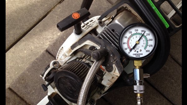

    Here's my 260 done by Randy a couple years ago. What's your elevation, Clint?

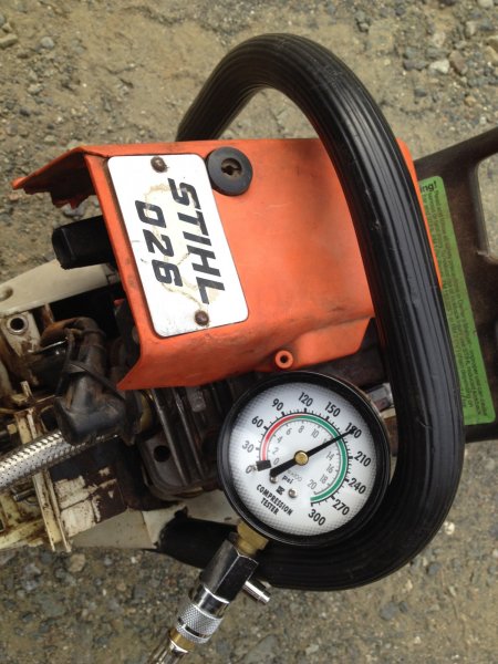

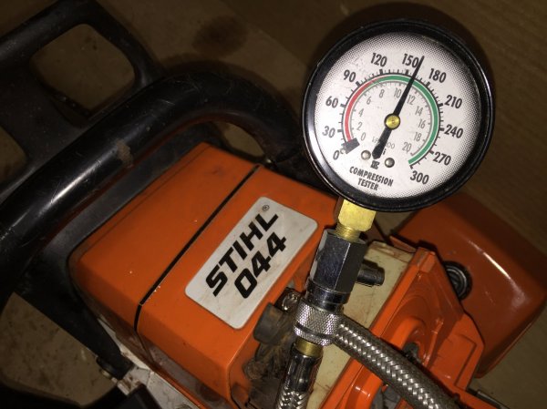

    Clint I had 3 of those gauges not read correctly before I give up and bought a snap on off ebay.

    It is kinda funny how they all say 180

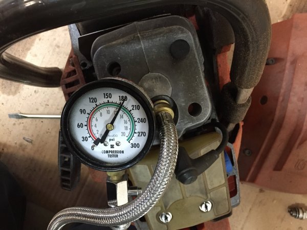

    They're not all 180. I do have a SnapOn tester somewhere. I guess I'll have to dig it out.
    044 w/ new Meteor piston... image.jpg
    288xp w/ base gasket delete... image.jpg
