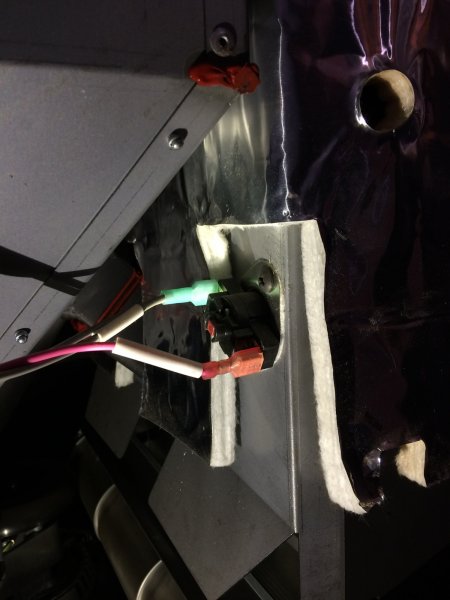

    As a "sanity check", I'd pull the clean-out plate (pg. 15) and observe the amount of ash in there: to make sure "over-draft" didn't pull ash from the firebox up there / plug it -> caused the trip switch on the high limit temp sensor to trip,
    New stove (shipping from east Asia?), I'd also be checking all connections inside the stove - to make sure none are loose / or disconnected during shipment/handling, if here.

    Ah ha! Hi temp switch-
    Air almost completely closed down....
    Violà-
    And now I have to go back to work....:salute:
    I bet this thing kicks that hi temp switch later if I run it for a couple hours....?

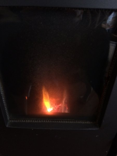

    It looks like you may need to "dial in" the damper control / intake air from that pic of the flame, and check the burn pot to make sure -all- holes are free / clean there Eric. It's a small stove - gotta keep the burn pot super-clean.
    FWIW, we clean the burn pot here every day, soaking it for about 10 mins. in a hot water / 1 teaspoon dish detergent mix, using a "green" or "black" heavy duty scouring pad, with a metal teaspoon used to gently "scrape" off any heavy carbon buildup (rare) makes cleanup easy.

    Yup, that's normal. Stove's control panel is 'torching' the remaining material out of the burn pot, with the auger feed shut off.
    Normal flame should be 'lively' and dancing / pellets should have a nice bright glow, not dull / overly orange or 'lazy'.

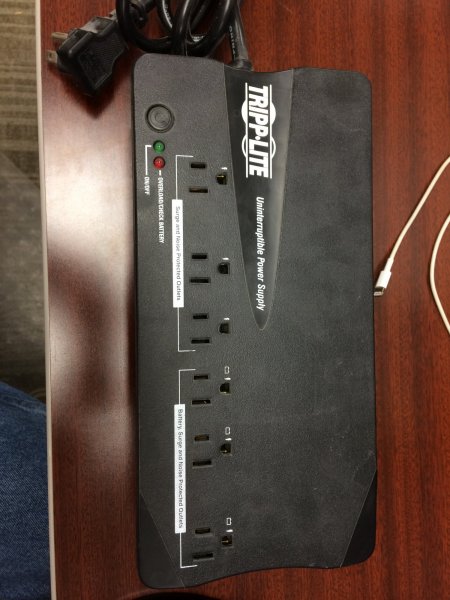

    So, 2 final questions......what did you do to get it to burn correctly, and do you have a good quality surge protector on it? The electronics on these things are prone to surges/spikes, and are $$$ to replace. A lot of members here use one of these:

    PS, I took his well advised suggestion for my stove too :) Then ended up with the sine wave UPS that IHATEPROPANE posts when there are really good deals on them :)

    Took the left side panel off during lunch, located the Hi temp limit switch, pushed the button in, hit power, had fire in a minute.:picard:
    Yes I will get a surge protector.:thumbs:

    So our IT guy walks by my desk and I ask him if he’s got any UPS’s laying around. Says “yeah if you don’t want the battery backup (cos the batteries are dead) but the surge protection is still there....
    He hands me this-
