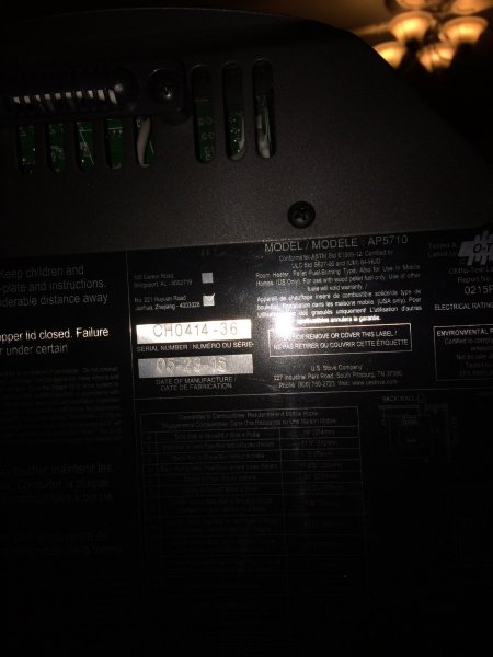

    Back of machine, indicating (if nothing else) it’s country of origin-

  3. imacman
    imacman
    Oct 23, 2013
    6,630
    27,517
    Denver, NC
    So what you're saying is that it was a brand new stove, correct?

  5. Eric VW
    24,541
    141,503
    Yes sir:yes:
