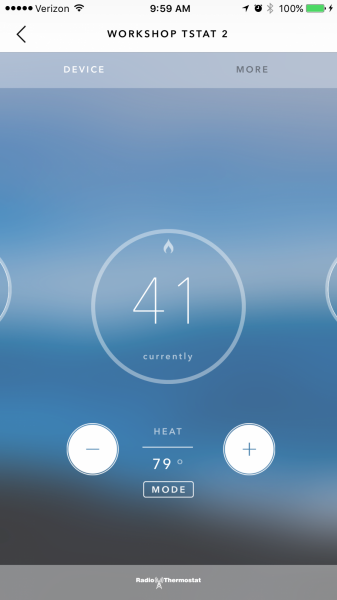

    Therefore I am also doing my own test of my new 22x12 workshop with hardly any insulation in New Hampshire in January
    Starting temp outside is 25 degrees and inside workshop is 41 degrees. After 1 hour it is 58 degrees with 48k BTUs Harman Advance set in room temp to 72 segrees
    After 1.5 hours it is up to 65 degrees F
    Looks like about 2 hours in this case.

    Pic 2 - starting workshop temp

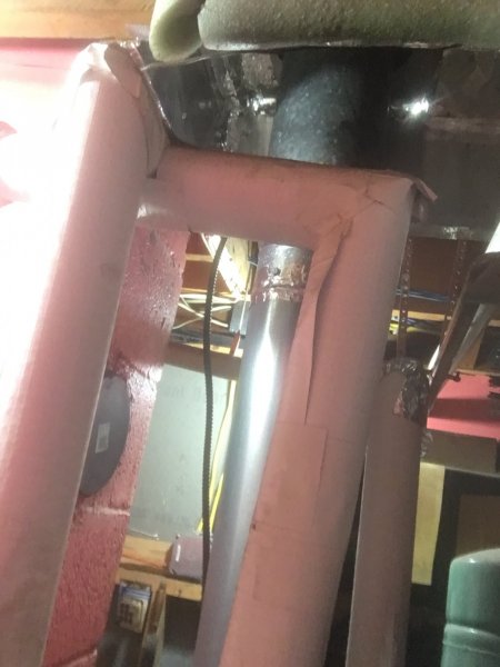

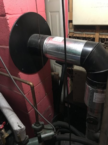

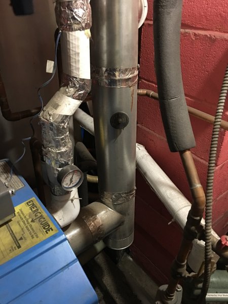

    Pic 1 - stove flue
    Pic 2-3 - new Stainless Steel furnace flue
