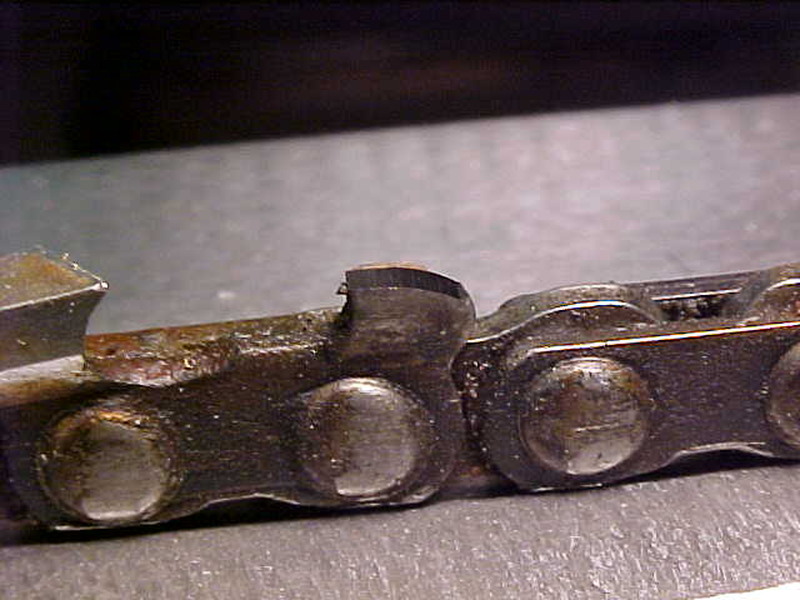

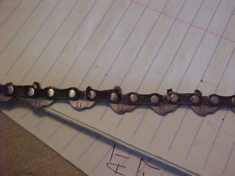

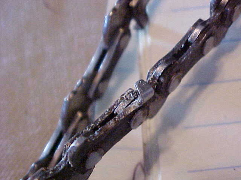

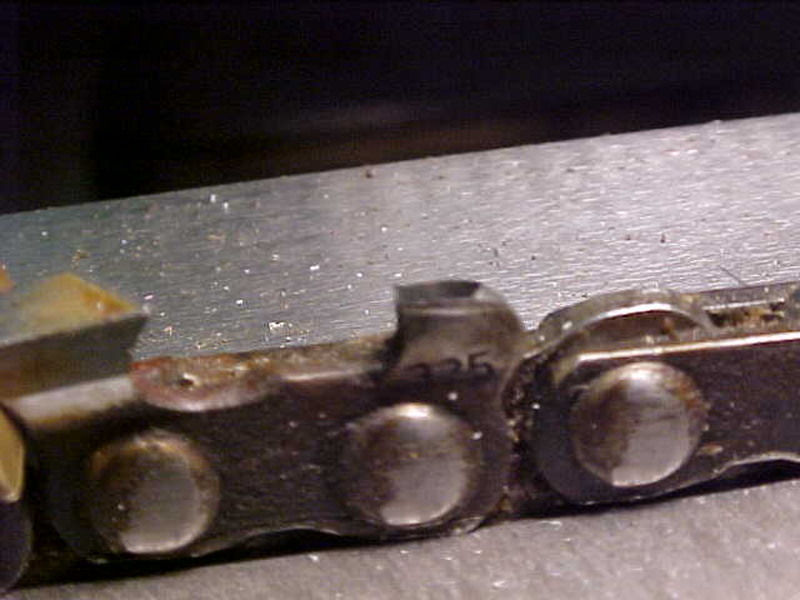

    I run them till they either start snapping the links at the rivets or when enough teeth are gone off one side that it won't cut. Even then it is used one more time for a stump chain.
    As long as the raker/depth gauges are set correctly it should cut like a new chain. When they get to this point is when they can let loose. If you are working in Dead locust, osage and the like it will pull them off quicker.
    This chain was used in trimming up dead Osage and you can see the tooth is bent from the pull. I switch out chains to a newer/stronger one to avoid this now.
    Pretty close to a blank chain when it stopped cutting.

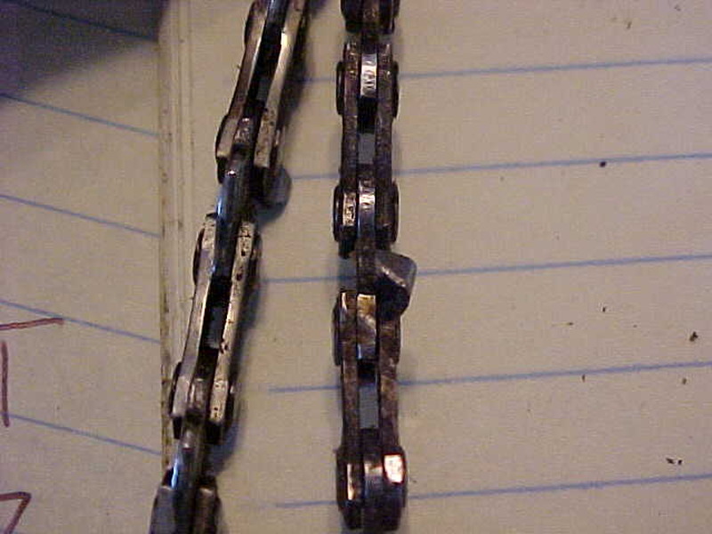

    The raker grinder I made up can dress any combo of factory spec'd design. It makes a big difference in the smoothness of the cut.
    Makes it nice and a fun experiment.
    Before
    After

    Most people file them flat but that will make for a less smooth cut from what I have found
    They will look like this.(before)
    This is after it's been brought back. this is the Stihl Picco style raker. If you are doing a lot of plunge cutting it makes a big difference. It cuts even or smooth on the tip when ground like this. Not a safety set up as you can get kickback so be aware of that. At least do a slight angle back as a hard front leading edge will cause more drag and chatter. Just something I've picked up on over the years.
    You should be able to do your rakers on most chain grinders. I'd suggest getting another wheel and hand dressing a slight angle and check with your gauge as you go.
