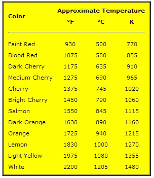

    I once had a wood stove cherry red
    abought 1400 degrees
  11. papadave
    Previous owners must have done something similar here. They popped a weld over a foot long and warped the back plate steel.
    Then, they left it for me.
    Took me a little bit to figure out why I couldn't control the stove.....but yeah, whatever.
