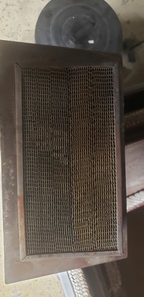

    I fought to get the fire going last night after burning up a bunch of cardboard, so today i pulled the cat out and cleaned it.
    Not sure you can tell from this pic, but i cleaned half then took a picture.
    Before
    Backwoods Savage and Hoytman like this.

    Looks like you cleaned the left side in the top picture.
  7. Hoytman
    Hoytman
    Dec 13, 2018
    1,254
    2,794
    OH
    Not sure which stove that CAT goes into, but the way it is made it looks like it just lifts out and drops into place. The gasket must lay in the stove and simply outline the frame of the CAT? At least it looks that way without seeing the rest of the stove. Beets trying to wrap a gasket around a CAT them finessing it back in place.

    That’s a Woodstock Ideal steel cat yes it sits in a hole on the “sled” and a lever pulls it overs smoke path when stove is to temp.
    pulling cat 1 and putting in spare is 2 minute, no tool , job that can be done when stove is in coaling stage.
