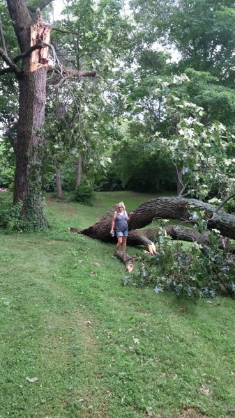

    The other end. Wouldn't want momma to drop the Pabst.:hair::D

    The other end, that tension near the trunk is massive, probably would roll.
