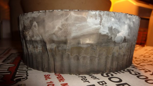

    I'm no chemist but I'd be concerned that the aluminum might react with the acidic vinegar, possibly depositing unwanted chemistry on the cat or worse, poisoning it.
    Well, my diesel-foil cat in the Dutchwest seemed to be dropping out too soon, and it has been a year since I checked it. It appeared to have some ash that wouldn't blow out so I simmered it out. Now I can see that some of the wash coat is peeling. It will be interesting to see if the cat works any better after the cleaning, but I've ordered a new Dura-Foil from Woodstock. They have a round one, 6" x 2", that fits their old Palladian and Classic stoves. That just happens to be the size I need for the Dutchwest. :thumbs:
  7. Woody Stover
    Woody Stover
    1,261
    3,046
    Southern IN
    The diesel-foil is definitely is working better after the simmer. Higher temps on less air, so the ash I got out of it definitely freed up the flow through it. There were little flakes of what looked like wash coat in the bottom of the pan. You can see that the cat is cone-shaped, smaller on the end that was toward the fire box. Not sure if the interam gasket could have squeezed it down a bit, or if that end just shriveled more. Can't wait to finally try the Dura-Foil I've got coming.
