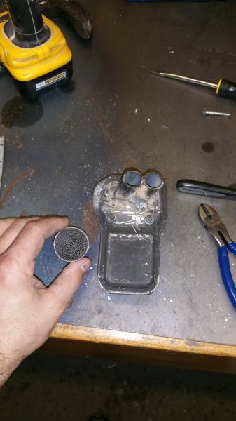

    clemsonfor Amy thoughts on what to do with this muffler?

    something like this i think

    millermodsaws has the right of it. If you want it to be not so loud find a way to cut just the cat out. If you don't care much about loud lose the whole plate. Those are pretty much the two main options.

    I bought a non cat muffler for mine and did a muffler modd for it.
    The screws I though on mine were either the spkined husky or single D style? Yours look just round and not like either? Maybe its the pic?

    MM is done, mighta gone a bit overboard. Cat is out, baffle plate still in, and i HAD to make it look fast..... and yes, a mig welder is on the list. Hard to do good work with a flux core..... Ill paint it tonight, run it tomorrow. Tach should be here tomorrow and tuning screw drives on monday.

    I think a bird got into your shop and pooed all over your muffler! Must be the same bird I have in my shop!:p Seriously though that looks pretty cool!

    Thats awesome!!! Your good if you can flux core something that thin!! I have never tried worried I would burn all kinds of holes in it!! Maybe I should take one of my junk mufflers and see if I can weld on it? Big stuff is no problem for me .

    The steel wool would probably start on fire. I wouldn't try it.
