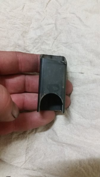

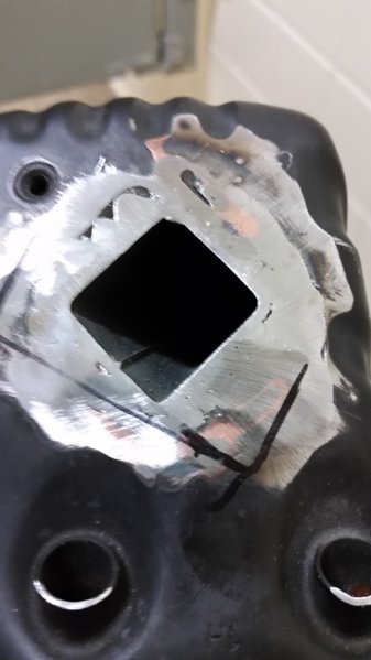

    A good example of this is the 550xp and 562xp. When I mod these I actually bend a peice if steel. 3 side face the open towards the from of the muffler and weld it down in under the deflector and then make a new deflector. I know confusing. Let me see if I can find a pic. But essentially this makes the sound bounce off the front off the muffler before exiting. Takes a lot of the high pitch crack out of them.
    Horkn, clemsonfor, Barcroftb and 3 others like this.
  12. millermodsaws
    millermodsaws
    Jan 15, 2015
    657
    2,010
    64479
    Here's pocs of the first 562xp I did. But maybe it'll help explain. When gutted these are a straight shot and loud. By adding the pipe angled forward it helped a lot with the high pitch cracks. A 550xp is actually worse! Lol downloadfile.jpeg downloadfile-1.jpeg downloadfile-2.jpeg

    What they look like finished! :) downloadfile-4.jpeg downloadfile-6.jpeg
