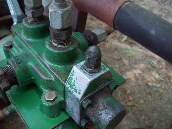

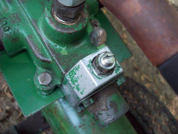

  7. Winch
    Winch
    Jun 16, 2020
    6
    42
    St. Louis, Mo
    It does look like an adjuster under the acorn nut. But it seems to be working more like I expect now. Since I started this thread I have moved it twice. Both times when we first set it up we had the back a little lower than the front and both times on the retract cycle hydraulic fluid gushed out of the air breather. Once I leveled it that quit. So I'm wondering if it might have been a little over full and now that some has come out it is working better?? If I want to try to adjust it which way would I turn the slot?
  8. Screwloose
    Screwloose
    Jan 15, 2017
    5,632
    33,296
    Clockwise.
  9. brenndatomu
    25,118
    163,226
    It shouldn't take much...1/4 - 1/2 a turn would be my guess...make sure you note where it was so you can go back there if it turns out to be something else...but it looks like a detent to me...
