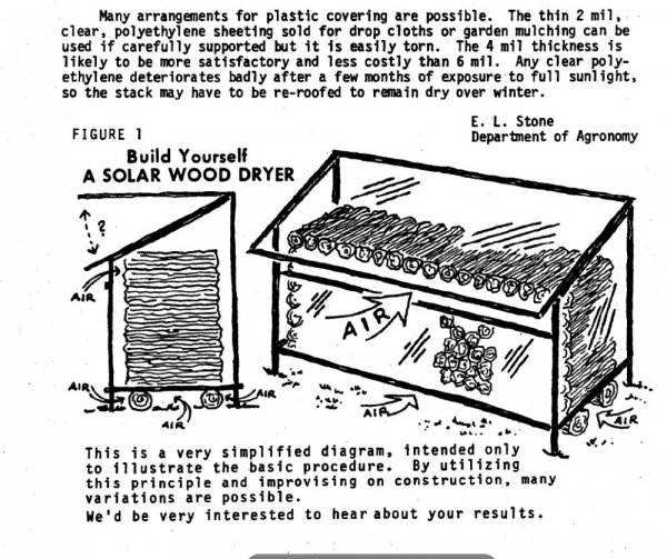

    If I'm thinking right I don't think you want vents, my understanding is the hot air is supposed to pull out the moisture and it will run down the plastic and drip off. So I believe you want to keep that greenhouse affect and not vent it.
    Hinerman likes this.

    Guess I saw the drawing & was thinking vents where arrows point to air
    Also thinking plastic on the ground under the pallets to prevent ground moisture

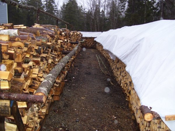

    I've showed this picture before of my "wood tent". It worked pretty well, until about two weeks ago when a big storm did a number on most of the plastic, which is just 6mil poly sheeting. I think the plastic choice will make a big difference, this stuff deteriorated enough after one summer of UV so that when it got cold it got very brittle and was no match for any wind. I've seen some clear plastic that has ribbons of some sort of reinforcement imbedded into it, maybe made specifically for greenhouses? I will not be going this route again, I enjoy splitting/stacking and have enough time/space to get way ahead and then into a shed. This was my way of trying to get the wood as dry as possible as quick as possible to overcome the starting from zero wood problem.
    WeldrDave and SolarandWood like this.
