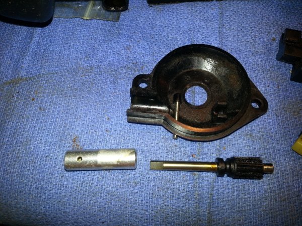

    The newer Poulan oil pumps have a "plunger" with a plastic gear on the end. The gear turns by a metal spring on the crankshaft. When plastic gear teeth wear, plunger doesn't turn every time-may hit a dead spot = less or no oil. I'll try to get pics later.

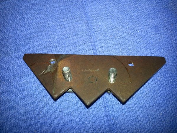

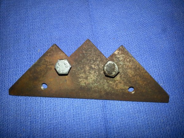

    Clutch tool on an air ratchet/hammer sure is easy but probably not worth the expense to do once every few years. You can make a clutch tool with a heavy mending plate. You contact both shoes rather than 1 with a hammer and rod, so clutch comes off easier - whack with a hammer after you've roped the piston. LHT - ClockWise is OFF.

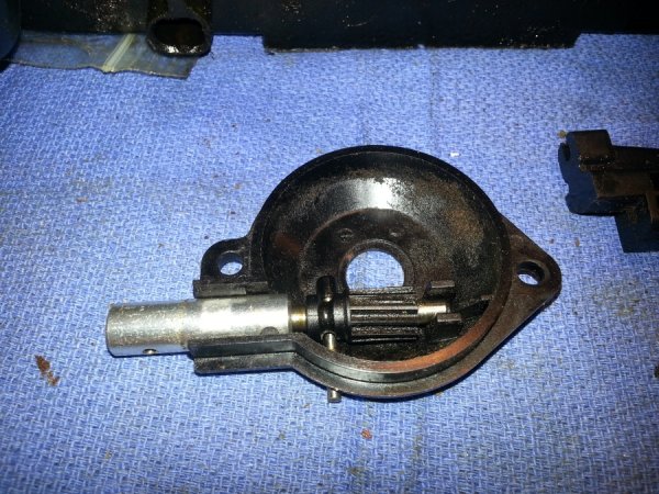

    Here are oil pump pics. See the nylon gear on the plunger. Those teeth wear.

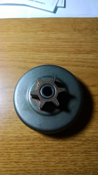

    I ordered the clutch tool yesterday, but I appreciate your posting of the homemade tool. I definitely like that design.
    I don't get the impact gun out enough anyways.:D
    Kinda bummed but doesn't look like I'll get the oiler till Monday, but tool and clutch drum should get here tomorrow.

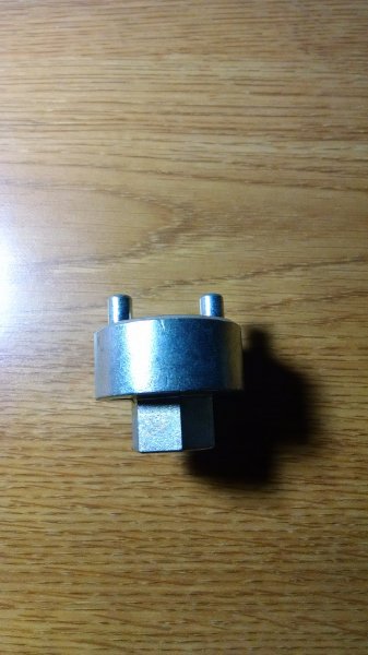

    Got the clutch drum and clutch removal tool as expected. :yes:
    But wait, what's this??
    Well.. I know this winter was long, bit didn't realize it was :santa: time again.

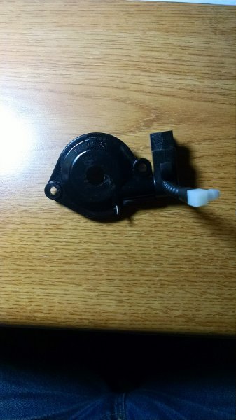

    The oiler wasn't supposed to be here till Monday. Looks like the weekend just got more interesting.
    So, now I have ALL the parts to make my little PP4218 all healthy again.:dremel::saw: (i like the first one, kinda looks like a doctor going in for surgery)

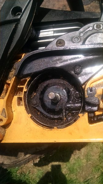

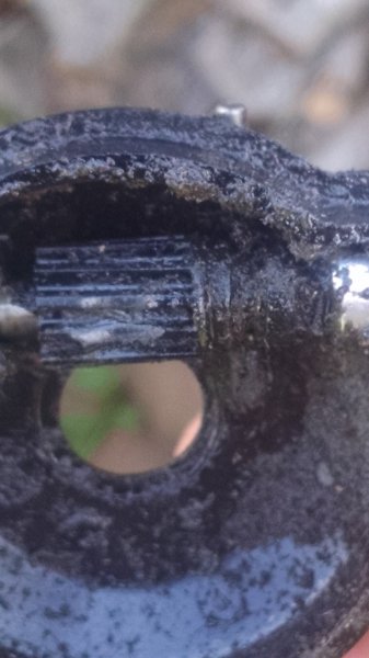

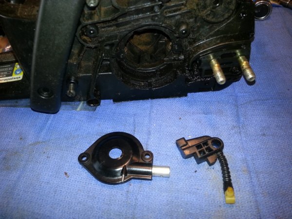

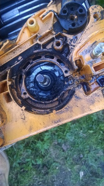

    I think I've found one more item I need to include as regular maintenance, that is tearing apart and cleaning it more often than once in 18 years or so. This is what I allowed to happen over the years of owning and running this saw.
    I'm a bit embarassed to post those pics, but it had to be done. :faint:
  14. brenndatomu
    25,269
    164,440
    Meh, that isn't that bad. You could clean it every year and it would be like that. I've seen way worse.
    Nice work on the DIY repair.

    Agree you can't keep area under sprocket very clean. And it not a problem unless grit gets on the plunger gear or in plunger tube and blocks hole. But very low risk.
