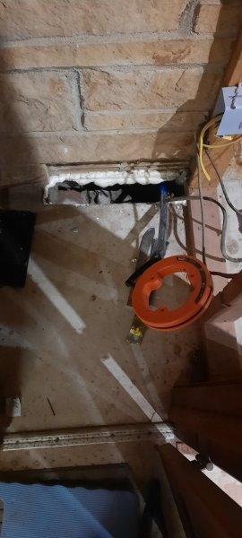

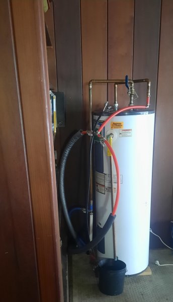

    I got more plumbing done where i can finally start repluming this master bath and still have a shower and toilet work in the other bath.
    So i ran 3/4" line, hot and cold, from the new water heater location to the bathrooms at the bedroom end of the house.
    Heres where they came out in the linen closet.
    Temporary location until bathroom is redone. 1/2" line got connected here and ran to toilet and shower.
    Where i tapped into the existing lines to keep a toilet and shower working. Forgot to take a picture with the pex connected before i put the wall panel back on.
    New lines at water heater.

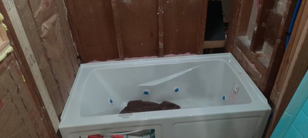

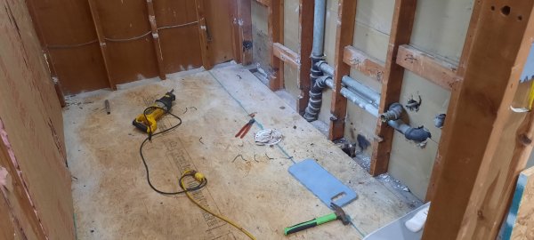

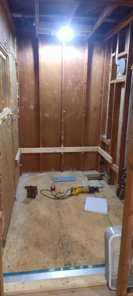

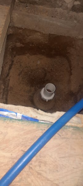

    Alright it's been a min since an update. Haven't made alot of progress visually but have got stuff organized and planned out that the tub and shower surround should go in pretty quick the next day or two. Went and got the rest of the supplies yesterday, now to actually do the work. Now to get yall caught up with pictures.
    All the old galvanized pipe outta the wall.
    Gonna leave the drains.
    Alcove kinda prepped.
    I'm a visual type person so i put the tub in place to get some motivation and see how everythings gonna line up.

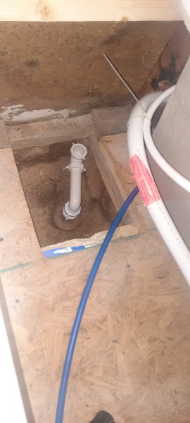

    Then came the fun part of designing/connecting the drain. The house is on a slab so it's not like i can just go downstairs and hook it up. Here's where the drain is. It's 1 1/2 steel threads.
    So i cleaned them (threads) up with a wire wheel and a plastic 1 1/2 drain nut threaded right on. (Test fitting)
    Now to get the tub outlet and drain inlet lined up.
    Found a double sink drain kit at menards that fit right on with a thick rubber washer and an immediate elbow which should help with the low profile, height wise, of the drain system.
    It should be pretty close and obviously slightly adjustable with the slip joints. I'll know better once i get the tub in place, take the adjacent bedroom wall paneling off, and see if there's enough room to fit my arm in there to hook everything up.

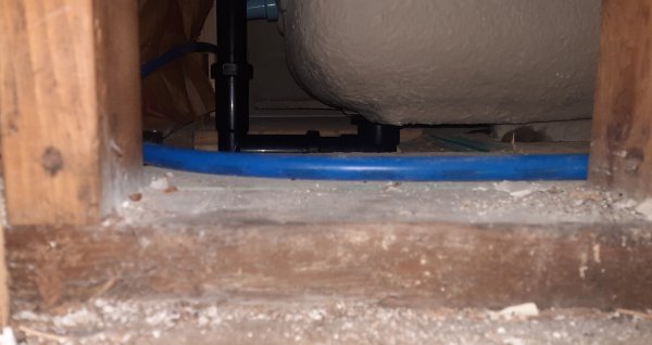

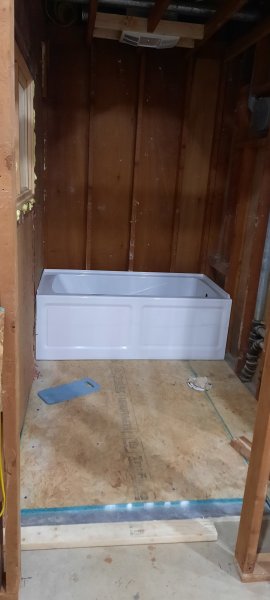

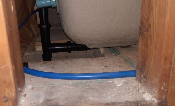

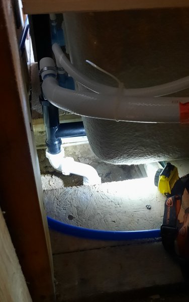

    Got the tub mortarred into place and drain connected. Here's the access i had to work in to connect the drain.
    Under the shelf view.
    Got it sized and connected.
    Hopefully these shows how tight it was.
    In place. Drain connection was made in the open bay in the back right.

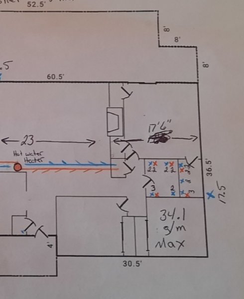

    Jeffrey, what program did you use for this? Is it free? Hopefully moving in 2026, very big room will be kitchen, dining and living room. I want washer/dryer in there too.
    Chaz, eatonpcat, theburtman and 3 others like this.
  19. Jeffrey Svoboda
    Jeffrey Svoboda
    2,905
    17,159
    Ehh..... it's been a long time coming. Just takes some thinking and making up ones mind. Now that doesn't sound fun. Lol
    Luckily it's only me here and my bed has been set up in a different room for a couple years now. I have another usable shower and toilet so it's no inconvenience really. Should be nice once it's done though.
    Ummm..... parts of it are free. Lol. The actual fancy outline/drawing of the house came from an appraisal of this house when i bought it. I just printed it out. Now for the colored pencil part...... that's all me. :rofl: :lol:
