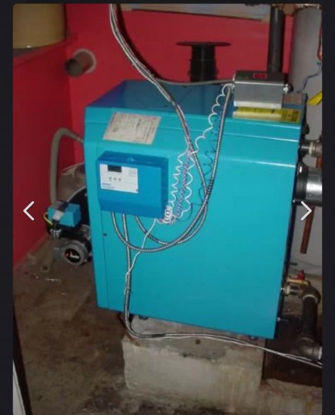

    I have a 40 gal SuperStor tank on a separate zone on the Buderus boiler with Tekmar control. It works well but they all die after a while so I just picked up an ECO Smart On Demand electric DHW panel from Home Depot for backup. :)
    By adding a cross over pipe and a ball valve I can switch in what ever DHW heater I want.
    Since I have a pellet stove running nearby to heat the house, when I switch to the electric on demand, I can still switch in the 40 gallon tank which gets heated by the pellet stove to 80 degrees by Osmosis, then the EcoSmart heats that from 80 to 140 degrees for greater efficiency. :)
