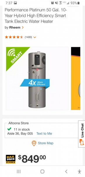

  15. TurboDiesel
    16,054
    95,671

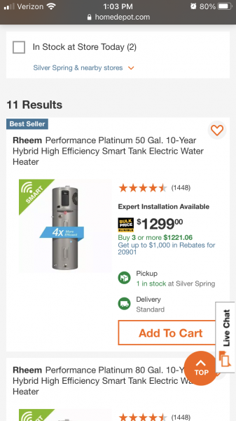

  16. mrfancyplants
    mrfancyplants
    Mar 21, 2019
    931
    5,118
    Maryland
    Same model / same website , different price:

  17. brenndatomu
    20,558
    128,099
    Good point!
    TurboDiesel and mrfancyplants like this.
  18. brenndatomu
    20,558
    128,099
    Same $1299 price here...when you come to the GTG you need to bring me a load of those things for me to sell here in Ohio Tim! :rofl: :lol:
