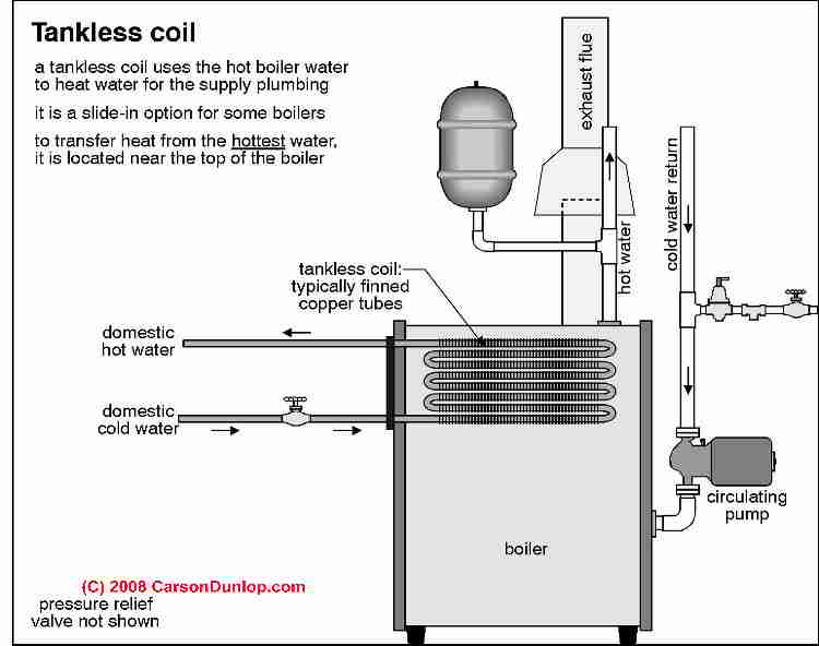

    Ray, is something like this what your are talking about?

    No it is a coil of finned copper pipe that is inside the hot water jacket for the boiler.. The tankless coil is heated by the same water that also circulates to the baseboard heaters.. More info at this link.. http://inspectapedia.com/plumbing/Tankless_Coils.htm
