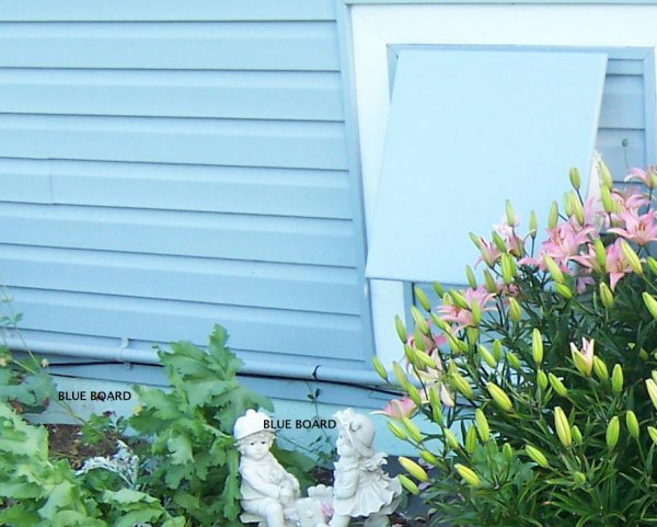

  2. bogydave
    Just below the siding, you can see the top edge of the 2" blueboard, goes 2' down

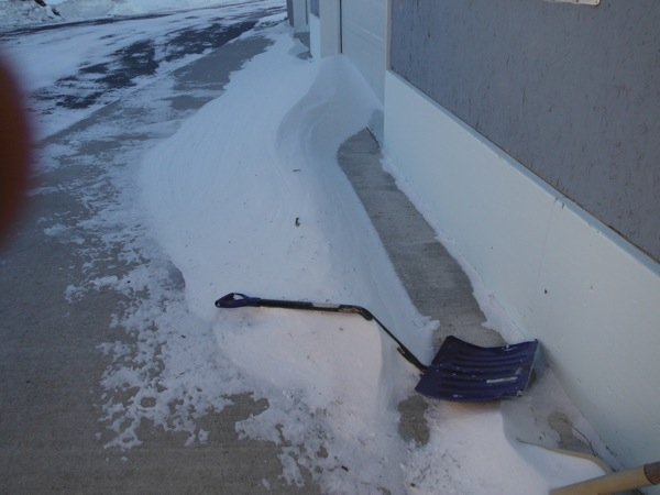

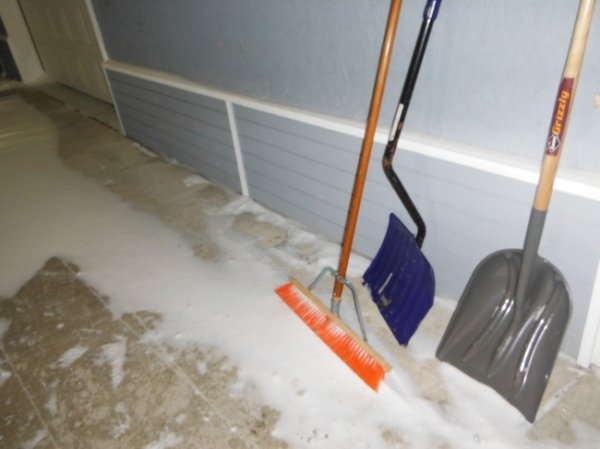

  3. bogydave
    I use blue board a lot.
    I covered the 24" concrete block , front wall on the heated part of the shop with 2" blue board, construction glued in place.
    Then cover the blue board with plywood siding, framed , glued , screwed, painted.
    Helped a lot, stopped condensation ,ice from forming on the inside front wall.
    Un-insulated concrete walls wick a lot of heat away from the inside.
    The other 24" block walls were covered with 2" concrete coated blueboard , then covered with metal flashing, then buried almost to the top.
