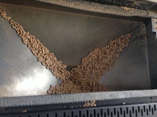

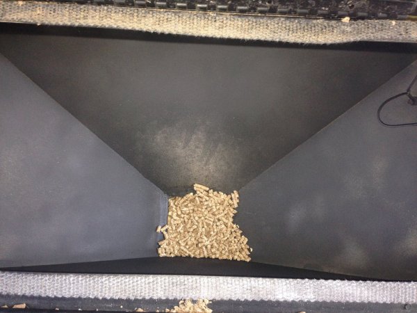

    So yesterday I put some aluminum tape and dry graphite to the hopper of the 55-TRPEP. I won't have results until this weekend at best. Pics to follow.
    Ps 15ft of Aluminum tape goes fast.....

    I have had hopper slide issues in the past with AWF WPs, Heat'rs and Vermonts. I tried a number of different techniques to solve it, but nothing really made an impact because the pellets aren't really sticking to the hopper. OK, maybe they are - but the real issue for me is they are sticking to themselves which creates that bridge effect. Once the gap forms down the middle of the hopper, the pellets at the ridge stick to the ones behind them and won't slide down. In the end, I gave up trying and settled on making sure the hopper is 100% full to the brim before I go to bed at night, otherwise I wake up to a cold house despite the fact the hopper is still half full of pellets! Recent seasons of Vermonts no longer do this, they must have found a way to bake them that eliminates the "tacky surface" issue.
    Interested to know if the aluminum tape helps your situation!

    So after running it out twice the verdict is........no difference. As some have alluded to I think these MWP are part of the issue. Currently I have a 18-20 lb real use hopper. I probably will not be trying any other pellets this season but will be sure to update this thread when I do and report the results.

    Green Supremes slid a bit better. Was able to burn 30 lbs before the stove ran out. At about 25 lbs you could tell that the auger was no lo get feeding a full load.
