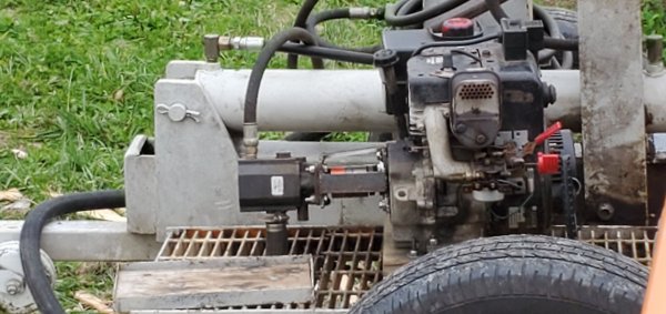

    Awaiting some sheet metal and self-tapping screws. Welding with a 120 mig on the only extension cord that I could find that had a resetting breaker was a pain. I need to run power to the front of my building.

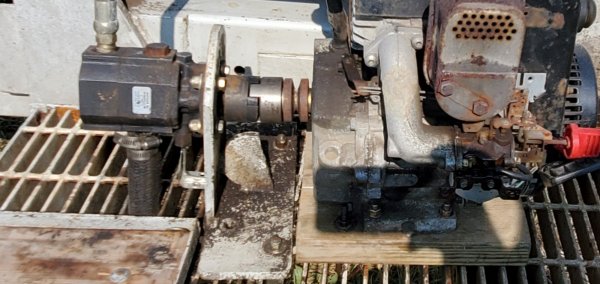

    Did you replace the lovejoy on the pump? In the last pic of the first page, it looks like a tooth on the pump lovejoy is pretty hammered, like it was run too long with worn out spider.

    Supposed to be here tomorrow. I need to take it apart again to paint it anyway.

    Here's a better pic of the original setup

    Geez, don't even need a straight edge to check the (mis)alignment on that one! :eek:

    It was more interesting as the non-nyloc nuts worked loose on the motor.

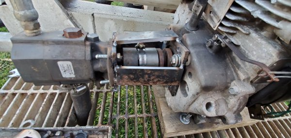

    Way more better'er!
