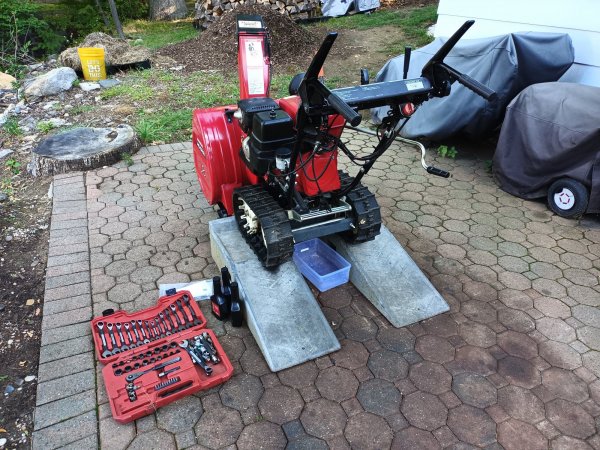

    Replaced the chute wire. Chute lever now works properly. Woo hoo!
    Picked up some Lucas 80w-90 gear oil at the local dealer as I was there picking up more shear bolts and more hydrostatic fluid.....because my neighbor just acquired the same exact unit and it needs servicing just like mine did.
    Nobody round here has 90W gear oil but given how seldom this is used I think it should be ok.
    stuckinthemuck and Horkn like this.

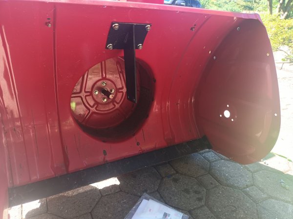

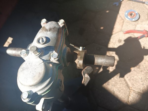

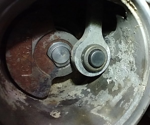

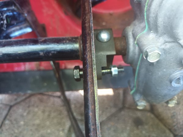

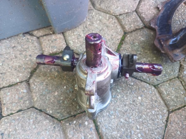

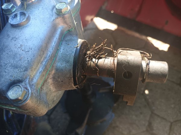

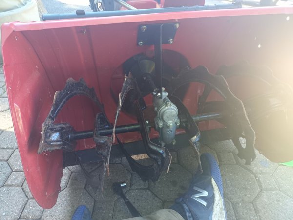

    Yeah the impeller housing is showing rust and the chute also has a bit as well. I should have just left the auger out and painted it. Now I'm going to have to take it all out again.....Although I might get lazy and just do it next year. :D

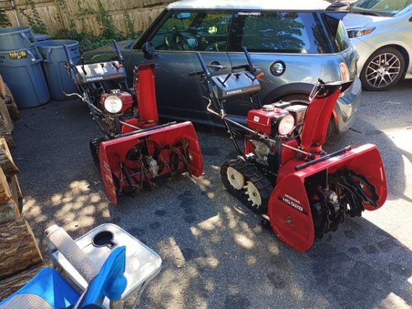

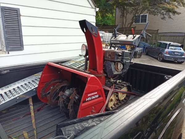

    Look..........the HS928 self replicated!!!! hahahahaha. Picked up ANOTHER identical HS928 today........for my neighbor. I had showed him a pic of mine and his eyes almost popped out of his head. Long story short I offered to drive and pick it up for him. Picked up some 1500lb straps at the Depot today since I used two of my 500lb straps to straighten one of my peach trees.....and they were pretty slick. No issues transporting and it was fun to use the ramps again. Luckily this bad boy started even though the fuel was pretty nasty.
    This one has more rust than mine although the chute wire works. Will do the tranny fluid, oil, and grease the augers and this time I'll dump the gear oil when I have everything apart!

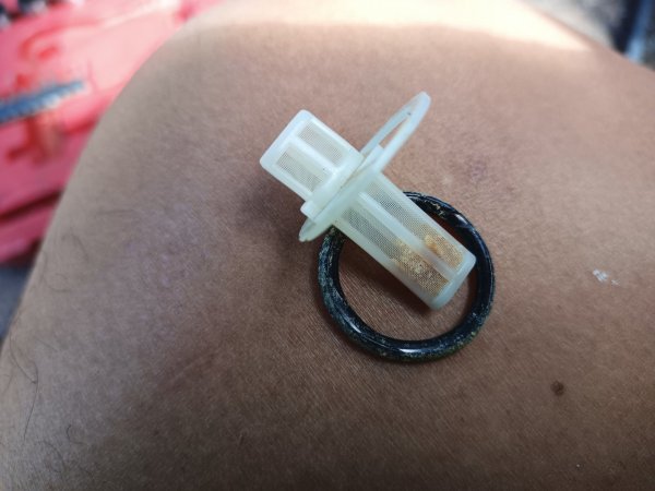

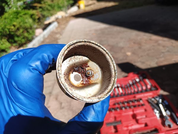

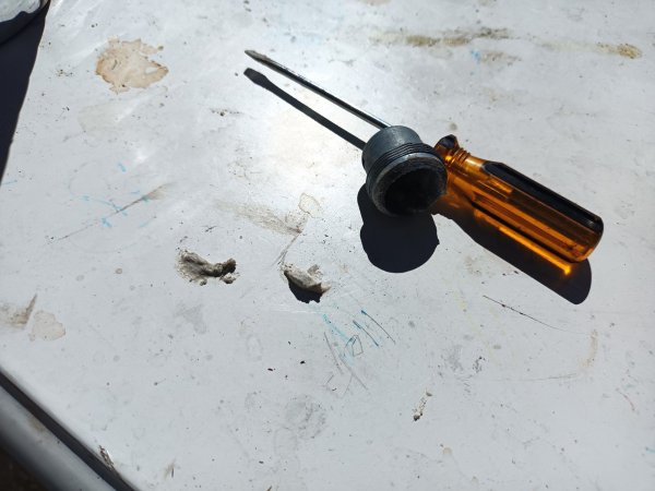

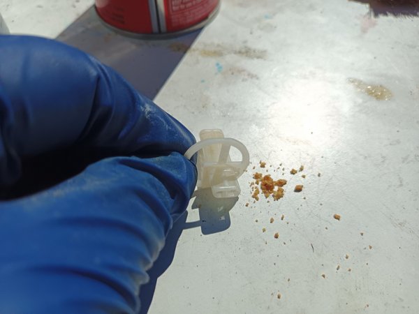

    The bowl in my HS928 was pitted and full of crap. The o-ring on the drain plug ripped. The gasket for the bowl is shot - cracked and brittle - and you have to order the bowl to get the gasket. First time ever taking out a jet and of course I had the wrong screwdriver and now I've stripped the damm thing. Ordered a conical straight edge screw remover from Amazon and should be here tomorrow. The fuel filter bowl had a white powdery susbstance and when wet looked like toothpaste. The filter itself looked like it had sawdust. Wtf!
    Soaked it in carb cleaner and scrubbed clean with a brass brush and then noticed the actual pitting at the base. I bet my neighbor's is worse.

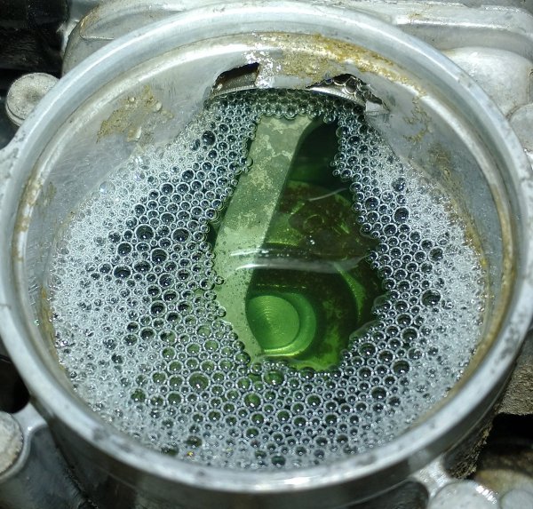

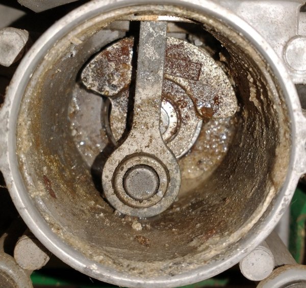

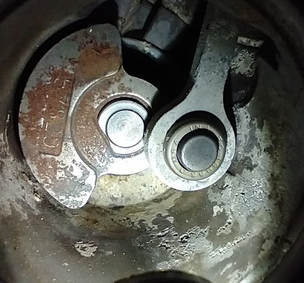

    Not that this is a competition but this is the worst ethanol mess I've seen. I thought it was sand. It wasn't. Just ethanol crystals and corrosion. IMG_20220929_090739110~2.jpg
    I hosed it out with carb cleaner. No visible rust on the crank or bottom rod bearing. You can see the pitting from the ethanol eating the case.
    Now its soaking with CRC inside. I'll leave it this way for at least 24 hours or more then I'm running it. I need to make sure it's good enough to wreck testing oil. :rofl: :lol:

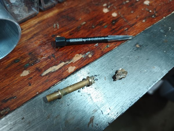

    Wow that looks pretty terrible for sure. Well, I failed in extracting the jet. That sucker was STUCK in there. I ended up having to drill it out and in the process messed up the emulsion tube. So then I just decided to order a new carb given the amount of corrosion to the bowl. I don't have an ultrasonic cleaner and figured I might as well just cut my losses here.
    I watched this video and got the extraction tool which I thought would work but man o' man that jet was STUCK.
