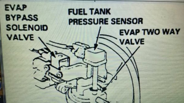

    No Luck, but the Check Engine Light goes on at mile 45 of the highway after a clear Computer Codes instead of at mile 38 during city driving.
    The codes are the same as last time except 4 that consist of 2 of each
    P1457 - Evaporator Control System Leakage (Evap Canister Area)
    P0420 - Catalyst System Efficiency Below Threshold B1
    Last time there were 3 codes, 2 of P0420 - Catalyst System and 1 of P1457 - Evaporator Control System
    After replacing the downstream O2 sensor
    Does that mean something different now?
    Is one of the Evap System Solenoids next?
    I do not have a scan tool with a functional tester. Has anyone used this tool to hear if each solenoid clicks to know if they work?

    It also could be an Evaporator Vacuum hose under the hood or a bad leaky gas cap.
    This is a great vid shows what maybe wrong.
    Has anyone seen this?

    The smoke test shows a leaky evaporator pipe. So we ordered a new one. :)

    The new evaporator pipe did not fix it!
    Everything points to a bad aftermarket Honda CRV catalytic converter which we got replaced under the warranty!
    My neighbor also said his aftermarket Honda catalytic converter did not last long and he was told that the OEM catalytic converter is recommended for this reason!!!!
